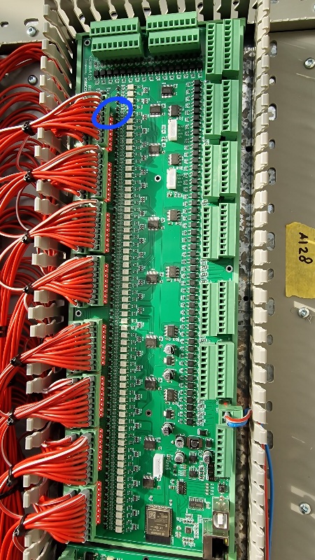

Hi i got a KC868-A128 with ESPHome on it code from this forum
My problem is if i enable Switch (switch.kincony_kc868_a128_a128_light65) the (switch.kincony_kc868_a128_a128_light49) goes on and if i switch (switch.kincony_kc868_a128_a128_light49) does the same switch on and off
if i enable all switches everything goes on except D132 on the board no light
i have attached the code and the log
