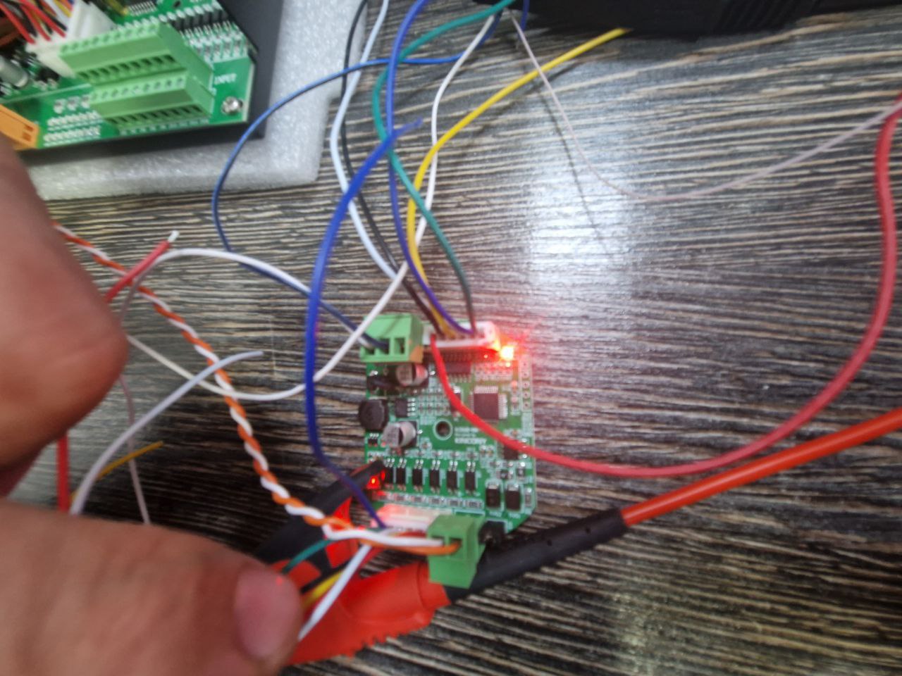

Good afternoon, please tell me the problem I have is that the output switches do not work. I configured everything as in the description on the guide hub. The inputs work in the Home assistant, but the outputs do not react, nothing, what did I do wrong?
.txt   Yamal.txt (Size: 7.88 KB / Downloads: 220)

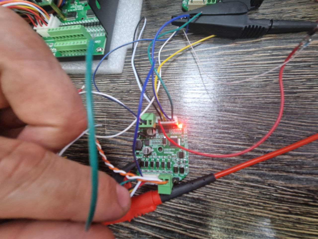

how do you test your output port? can you take a photo?
Video of input working and output not working I can’t send the video here’s the photo
(11-02-2023, 10:54 AM)Kataktok Wrote: Video of input working and output not working I can’t send the video here’s the photo
Hoi Kataktok,
Be aware that the output of the kc868-HA is active - LOW !

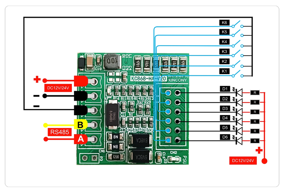

[Image: detail1_03.jpg]
test output as this way, this is KC868-HAv2 PCB, but v1 PCB is same.

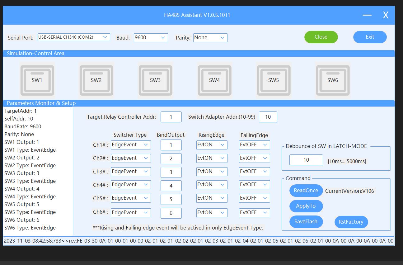

I downloaded the firmware from here https://www.kincony.com/forum/showthread...t=kc868-ha  .Now I changed it to version 106 but it still doesn’t work, the state doesn’t change. I tried the same thing with 2 boards. Help please, what's wrong? what am I doing wrong?
(11-03-2023, 04:54 AM)Kataktok Wrote: I downloaded the firmware from here https://www.kincony.com/forum/showthread...t=kc868-ha  .Now I changed it to version 106 but it still doesn’t work, the state doesn’t change. I tried the same thing with 2 boards. Help please, what's wrong? what am I doing wrong?
check the pin is right
