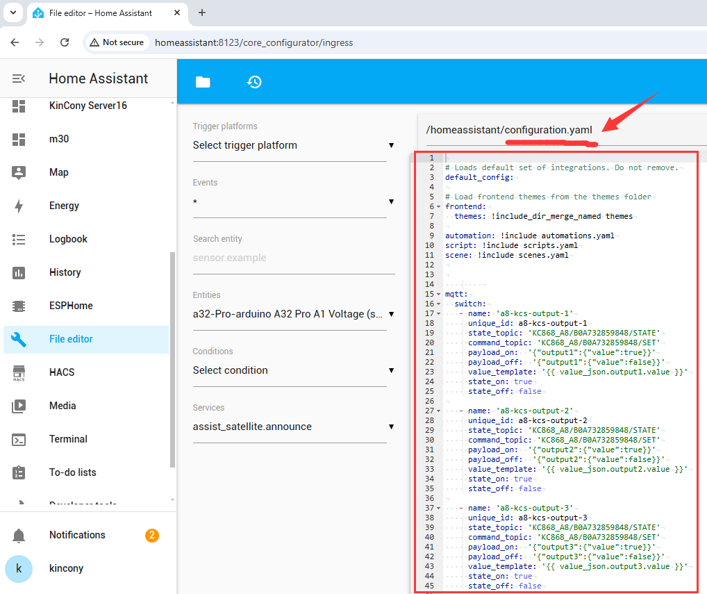

step3: modify configuration.yaml file, add our code:

step4: replace all ID by your own board, you can check ID from KCS "index" webpage.
step5: save the yaml file by click "save" button. Then ready to restart of home assistant.
step6: go to "setting" -- "system" webpage, restart your home assistant.
step7: Now you can found new entities in "Setting" -- “Device & services" -- "Entities" webpage. all have listed, you just add to home assistant dashboard is OK.
