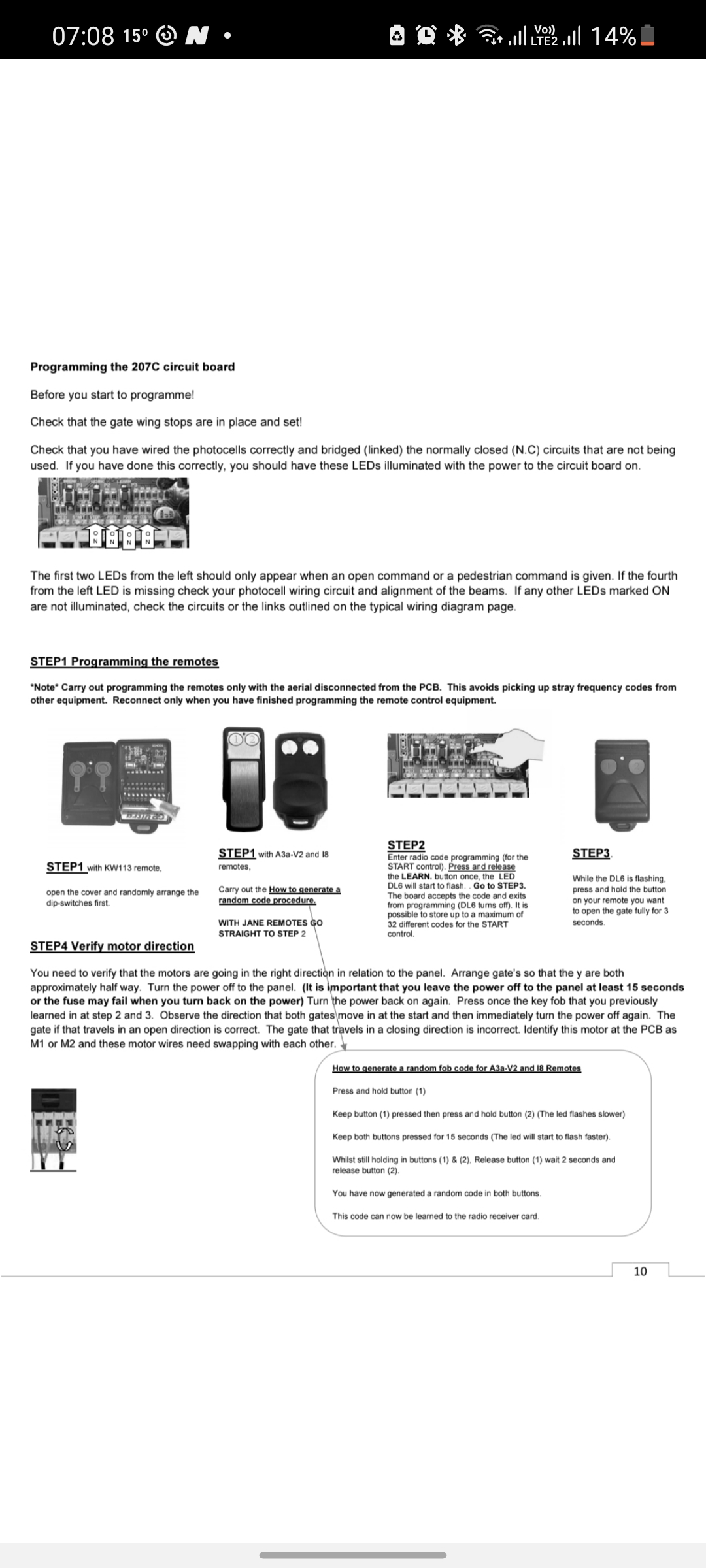

Dear customer support
Please find attached the page related how to learn the 433MHZ remote control for my gate motor.
The gate motor and 2 remote controls for me and my wife are programmed.
I need to control the gate using 4G outside my house network.
Please confirm that my gate motor board will accept the K868-AG code and learned.
I need to control the gate using 4G outside my house network using Kincony smart home system.
Please see the attached gate motor manual i think page 10 discussing how to learn to 2 button key fob that i had.
.pdf   207-SM-Control-panel-for-swing-gates-12VDC-and-24VDC.pdf (Size: 2.08 MB / Downloads: 1,166)
#18
take a photo of this wireless code chip, need to see the IC model.
