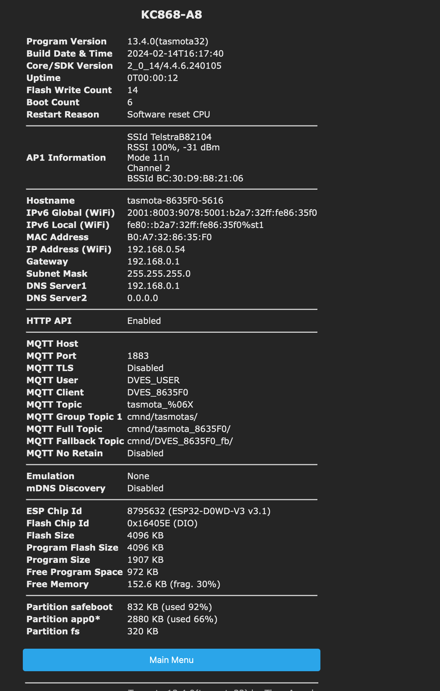

Hi, Im trying to set up KC868-A8 forTasmota. The KC868 Firmware bin doesn't flash from Tasmota ESPFlasher 2.2.3, so I flash with base Tasmota32.bin, all good.
Set up wifi and log into ip through browser, no problem.
There I can update firmware to the downloaded KC868-A8-Tasmota-firmware.bin .no worries.
Next, Configuration Other, copy and paste the template {"NAME":"KC868-A8","GPIO":[32,0,1120,0,640,608,0,0,0,1,1,1152,0,0,5600,0,0,0,0,5568,0,0,0,0,0,0,0,0,1,1,0,0,1,0,0,1],"FLAG":0,"BASE":1,"CMND":"EthClockMode 3 | EthAddress 0 | EthType 0 | I2CDriver2 1"} All Ok From there I can't configure the PCF8574, it doesn't seem to find the device or give option to configure it, so I can't set up IO at all......

but it doesn't activate the PCF8574 still. Any ideas?
