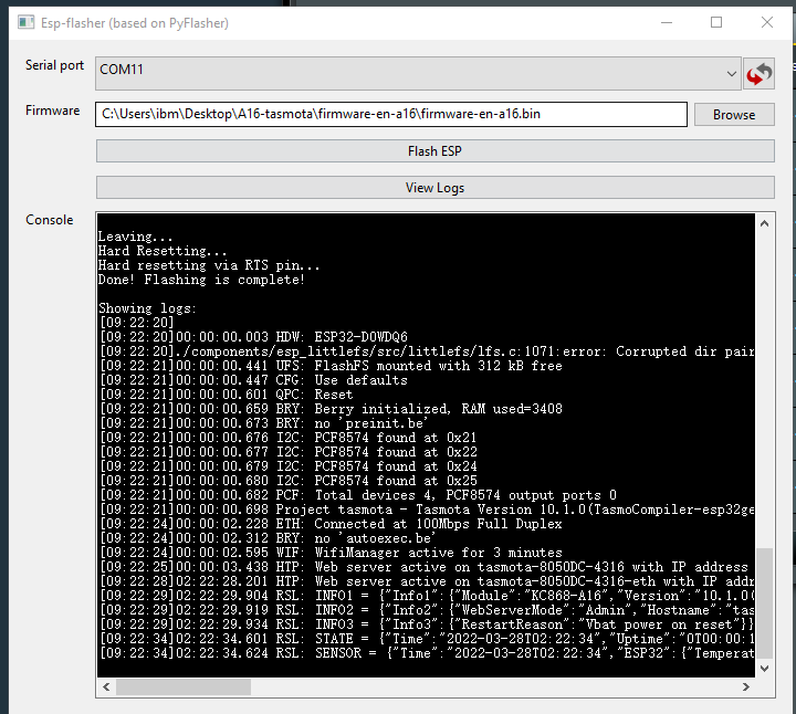

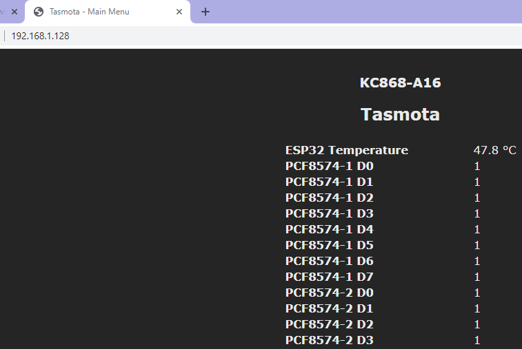

Yeap,
I flash with your firmaware, and Ethernet doesn't work
See your ESP logs : eth is active (9:22:24)
Mine doesn't work at all (I test with my cisco switch, and others (in case)), test on macOS, windows, test on my second card KC868-A8 (I bought two)
I'm pretty sure that your firmware ready to download doesn't work properly (maybe corrupted), can you send me your firmware used during your test ?

Showing logs:
[06:06:18]
[06:06:18]00:00:00.003-218/71 HDW: ESP32-D0WD
[06:06:18]./components/esp_littlefs/src/littlefs/lfs.c:1071:error: Corrupted dir pair at {0x0, 0x1}
[06:06:19]00:00:00.817-216/71 UFS: FlashFS mounted with 312 kB free
[06:06:19]00:00:00.824-216/71 CFG: Use defaults
[06:06:19]00:00:00.957 QPC: Reset
[06:06:19]00:00:00.000 BRY: Berry initialized, RAM used=3294
[06:06:19]00:00:00.012 BRY: no 'preinit.be'
[06:06:19]00:00:00.022 Project tasmota - Tasmota Version 10.0.0.3(tasmota)-2_0_1(2021-11-14T21:44:07)
[06:06:19]00:00:00.037 BRY: no 'autoexec.be'
[06:06:19]00:00:00.335 WIF: WifiManager active for 3 minutes
[06:06:20]00:00:01.247 HTP: Web server active on tasmota-0B8E9C-3740 with IP address 192.168.4.1
[06:09:24]00:03:05.329 APP: Restarting
[06:09:25]
[06:09:25]00:00:00.003 HDW: ESP32-D0WD
[06:09:25]00:00:00.029 UFS: FlashFS mounted with 308 kB free
[06:09:25]00:00:00.100 CFG: Loaded from File, Count 4
[06:09:25]00:00:00.116 QPC: Count 1
[06:09:26]00:00:00.200 BRY: Berry initialized, RAM used=3504
[06:09:26]00:00:00.218 BRY: no 'preinit.be'
[06:09:26]00:00:00.223 Project tasmota - Tasmota Version 10.0.0.3(tasmota)-2_0_1(2021-11-14T21:44:07)
[06:09:26]00:00:00.243 BRY: no 'autoexec.be'
[06:09:26]00:00:00.480 WIF: WifiManager active for 3 minutes
[06:09:27]00:00:01.153 HTP: Web server active on tasmota-0B8E9C-3740 with IP address 192.168.4.1
[06:09:32]00:00:06.873 QPC: Reset

i see, sorry, your board is KC868-A8, but these photos i have downloaded is KC868-A16.we will test with KC868-A8 this week when have free time, then feedback to you.
