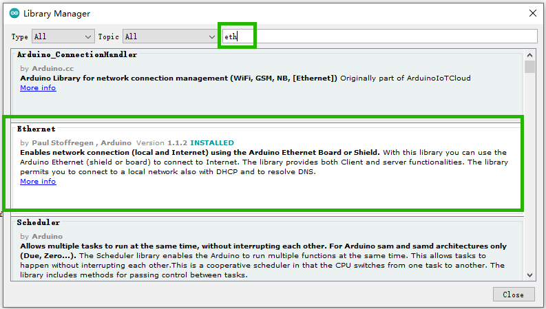

Code 4: //The demo code is LAN8720-UDP You can copy the code to your Arduino IDE
