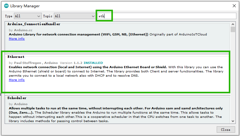

[Arduino IDE demo source code for KC868-A16]--#06-LAN8720-UDP
Rainbow
Code 5: //The demo code is LAN8720-UDP    You can copy the code to your Arduino IDE
#include <ETH.h>
#include <WiFiUdp.h>
