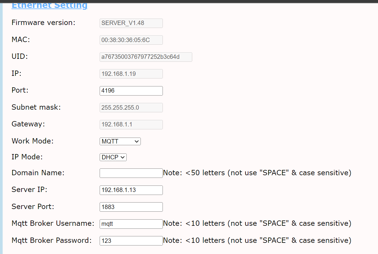

do you see the "Note" of network setting webpage, "Mqtt Broker Username" and "Mqtt Broker Password" need <10 letters, now yous is too long, just change it.
such as "Mqtt Broker Username" = "mqtt" "Mqtt Broker Password"= "123" i think will be ok.

It helped to create an additional person in home assistance, the new person has access to login, you need to set a short password and the same password and username can be used as the mqtt broker name in the Kincony server settings. thanks !

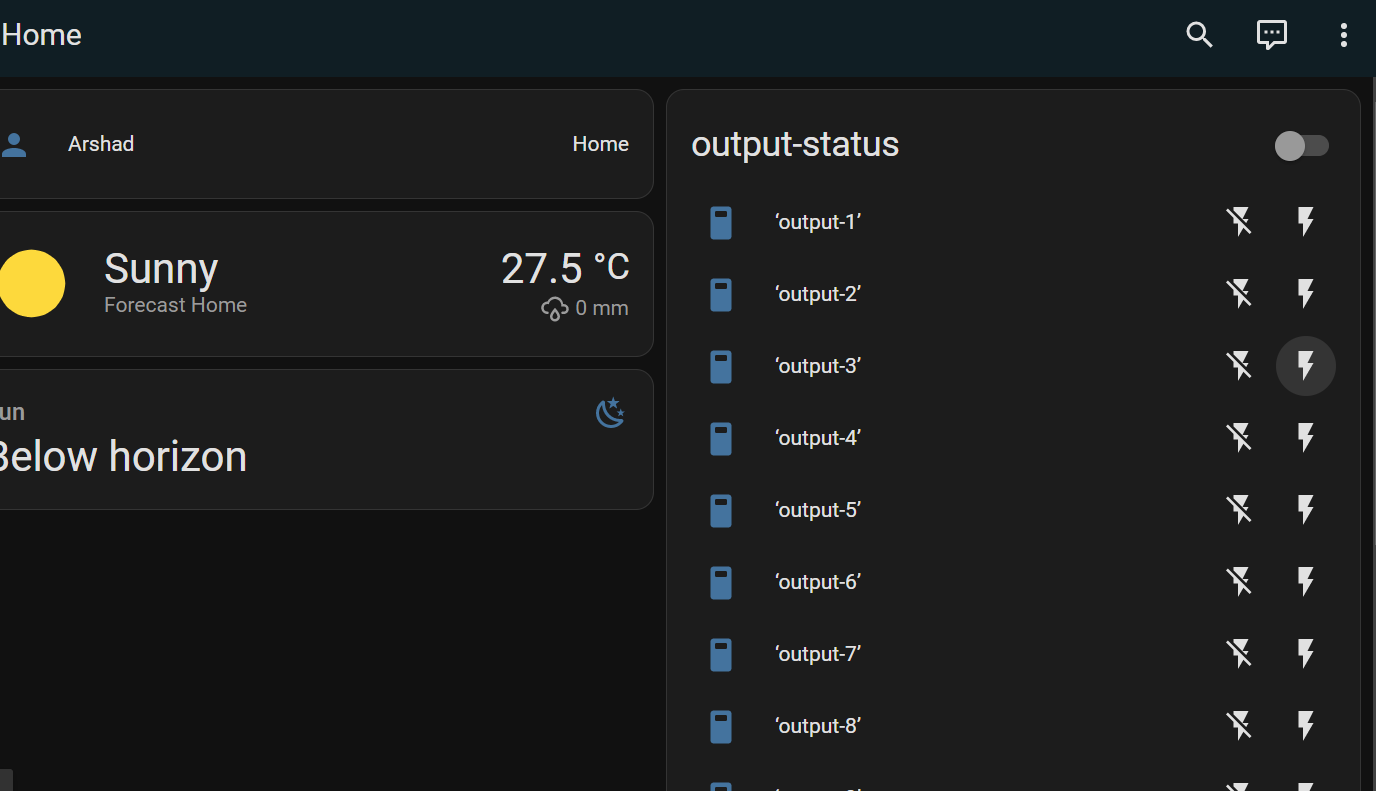

Hello Sir,
i have done MQTT setting as per training like (username and password). Now from ESPHome (HomeAssistant - phone app) status of output is off
but in Server light is showing ON
Trying to off but not working please hep - i have attached all photo of configuration.

you are using KC868-server, so topic: ‘relay32/a76735003767977252b3c64d/state’ replace with ‘server/a76735003767977252b3c64d/state’
topic: ‘relay32/a76735003767977252b3c64d/set’ replace with ‘server/a76735003767977252b3c64d/set’
NOT "relay32".

(04-11-2023, 12:06 AM)admin Wrote: you are using KC868-server, so topic: ‘relay32/a76735003767977252b3c64d/state’  replace with ‘server/a76735003767977252b3c64d/state’
NOT "relay32".
Example of config:-
mqtt:
  - name: ‘output-1’
    unique_id: output-1
    state_topic: ‘server/a76735003767977252b3c64d/state’
    command_topic: ‘server/a76735003767977252b3c64d/set’
    payload_on: ‘{“relay1”:{“on”:1}}’
    payload_off: ‘{“relay1”:{“on”:0}}’
    value_template: ‘{{ value_json.relay1.on }}’
    state_on: 1
    state_off: 0
i have changed the configuration file for all the 16 output but not working -- Output Light status is showing "ON" - trying to make it "off" not working
