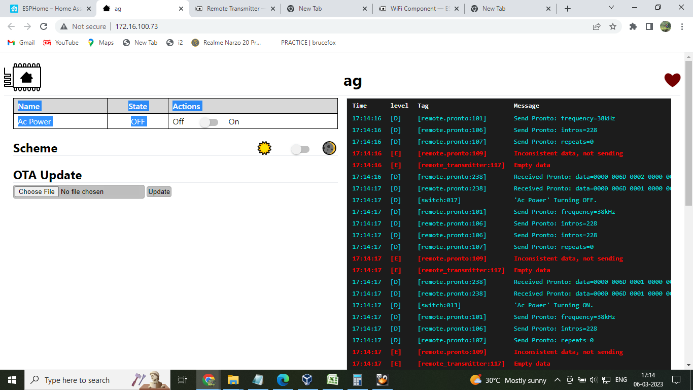

(03-06-2023, 08:21 AM)admin Wrote: if ESPHome log no output when you pressed your ac's remote button, i think your ac is not use 38khz standard IR signal, so that ESPHome can't decode. based on your statement esp home cant connect to my whirlpool model ac is that correct? (03-06-2023, 09:56 AM)PIQ user Wrote:(03-06-2023, 08:21 AM)admin Wrote: if ESPHome log no output when you pressed your ac's remote button, i think your ac is not use 38khz standard IR signal, so that ESPHome can't decode. no when i press the remote button pronto codes are received and i use the pronto codes to the log file but ac cant working
03-06-2023, 10:27 AM
ESPHome decode to some types: i have seen your log file. JVC,LG,NEC
maybe signal is simlar. you can try to send by different command , replace this "- remote_transmitter.transmit_pronto:" with another code type for a test, such as: - remote_transmitter.transmit_nec: remote_transmitter.transmit_jvc: (03-06-2023, 10:27 AM)admin Wrote: ESPHome decode to some types: i have seen your log file. JVC,LG,NEC no my ac remote only providing pronto codes and i click the climate entity buttons in webpage so the nec,jvc and lg codes are displayed (03-06-2023, 10:27 AM)admin Wrote: ESPHome decode to some types: i have seen your log file. JVC,LG,NEC i send the pronto codes but this kind of error showing any syntax mistakes?
