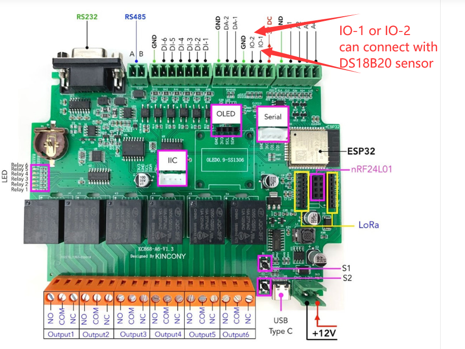

Hello, I use sensor ds18b20 with Tasmota, but did not work.
how is it connected? and which pin to set? Thank you
here are "IO-1" and "IO-2" with KC868-A6, that can connect to DS18B20
here is photo
(05-08-2023, 12:55 AM)admin Wrote: here are "IO-1" and "IO-2" with KC868-A6, that can connect to DS18B20
here is photo
Thank you , now it  work.
best wishes
ok, good.
