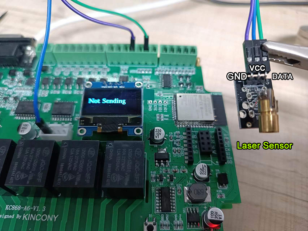

【Sensor series program】-#02-Arduino code of KC868-A6 and Laser Sensor
#include <U8g2lib.h>
#include <Wire.h>
U8G2_SSD1306_128X64_NONAME_F_SW_I2C u8g2(U8G2_R0, 15, 4, U8X8_PIN_NONE);//SCL IO15 SDA IO4
void page1() {
u8g2.setFont(u8g2_font_timR14_tf);// Font 18
u8g2.setFontPosTop();
u8g2.setCursor(5,20);
u8g2.print("Sending Lasers ");
void page2() {
u8g2.print("Not Sending");
void setup() {
pinMode(0,INPUT);
pinMode(32,OUTPUT);
u8g2.setI2CAddress(0x3C*2);
u8g2.begin();
u8g2.enableUTF8Print();
void loop() {
if(digitalRead(0)==LOW)
digitalWrite(32,HIGH);
u8g2.firstPage();
do
page1();
}while(u8g2.nextPage());
else
digitalWrite(32,LOW);
u8g2.firstPage();
do
page2();
