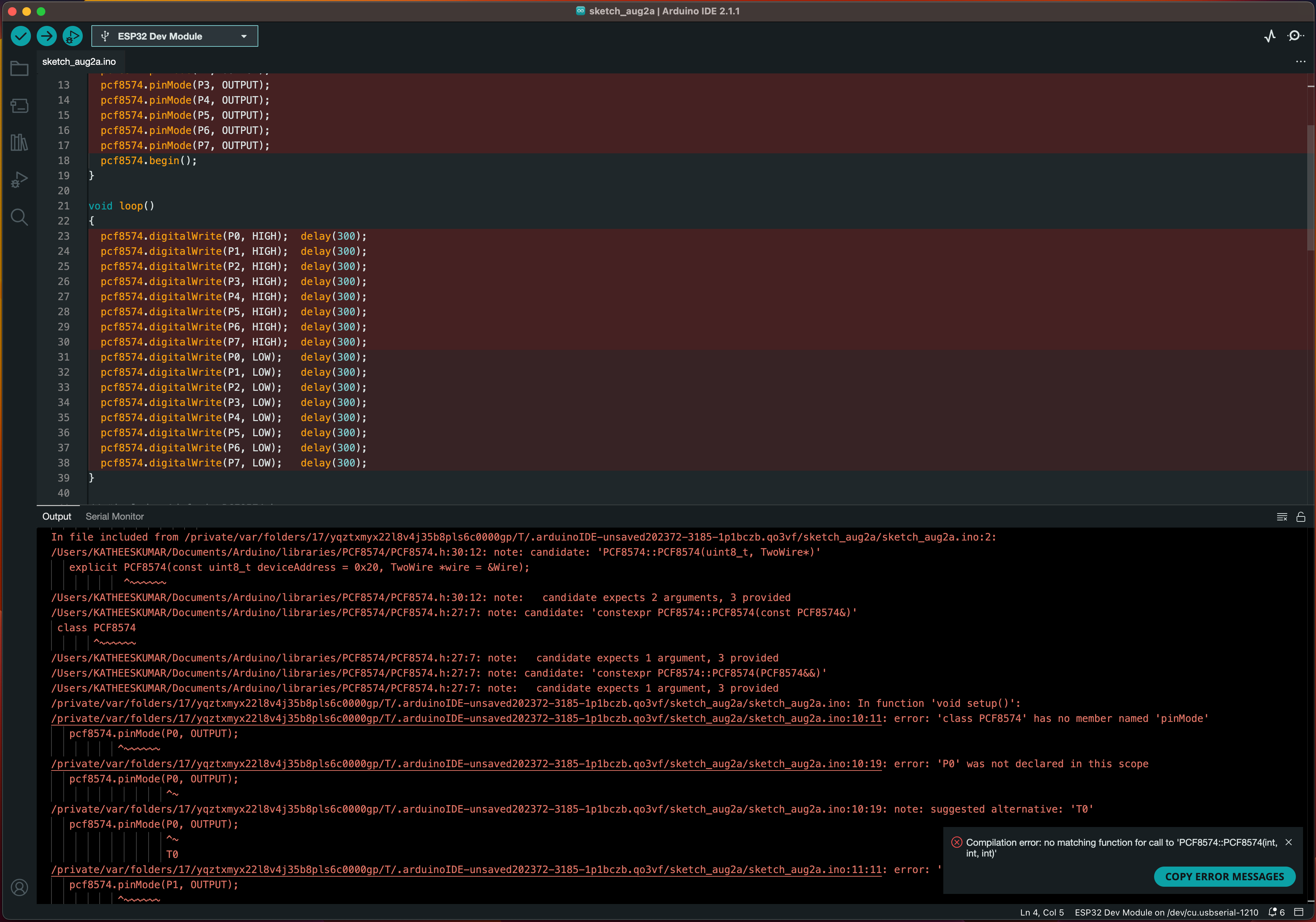

How to solve this issue? your example code is not compiled by my Arduino IDE. help me to solve this issue!
here is PCF8574 arduino library we have used.
.zip   PCF8574_library.zip (Size: 23.8 MB / Downloads: 245)
