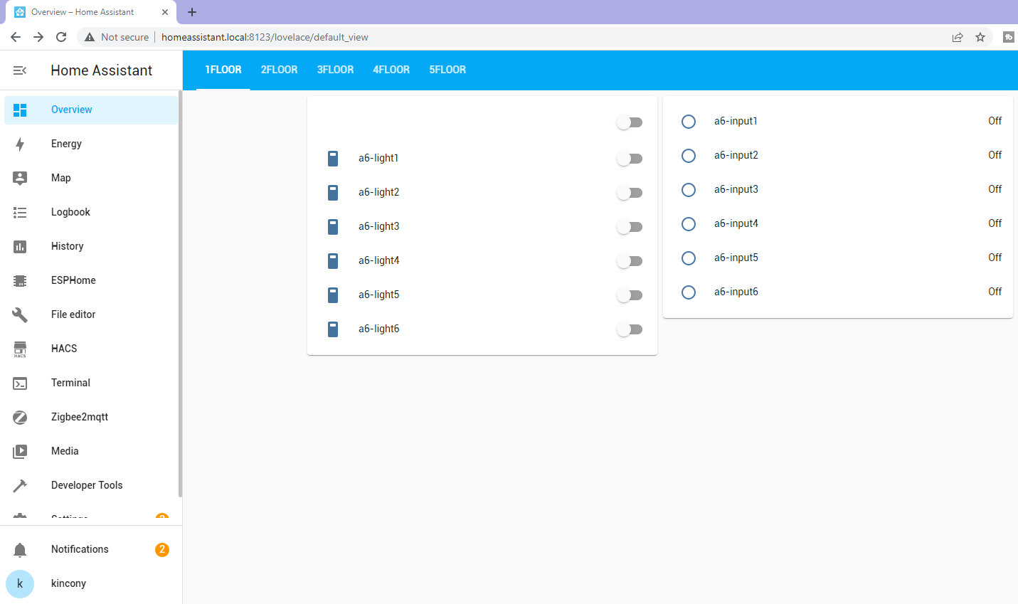

KC868-A6 ESPHome demo config for home assistant
esp32:
  board: esp32dev
  framework:
    type: arduino
# Enable Home Assistant API
ota:
  password: "b9c07c109b7ecc6c63dac976c0c23a12"
wifi:
  ssid: KinCony
  password: xxxxxxxx
  ap:
    ssid: "A6 Fallback Hotspot"
    password: "GLdHSsZr1p96"
captive_portal:
i2c:
  sda: 4
  scl: 15
  scan: true
# Example configuration entry
pcf8574:
    address: 0x24
    address: 0x22
# Individual outputs
  - platform: gpio
    pin:
      pcf8574: pcf8574_hub_out_1
      number: 0
      mode: OUTPUT
      inverted: true
  - platform: gpio
    pin:
      number: 1
      mode: OUTPUT
      inverted: true
  - platform: gpio
    pin:
      number: 2
      mode: OUTPUT
      inverted: true
  - platform: gpio
    pin:
      number: 3
      mode: OUTPUT
      inverted: true
  - platform: gpio
    pin:
      number: 4
      mode: OUTPUT
      inverted: true
  - platform: gpio
    pin:
      number: 5
      mode: OUTPUT
      inverted: true
binary_sensor:
  - platform: gpio
    pin:
      pcf8574: pcf8574_hub_in_1
      number: 0
      mode: INPUT
      inverted: true
  - platform: gpio
    pin:
      number: 1
      mode: INPUT
      inverted: true
  - platform: gpio
    pin:
      number: 2
      mode: INPUT
      inverted: true
  - platform: gpio
    pin:
      number: 3
      mode: INPUT
      inverted: true
  - platform: gpio
    pin:
      number: 4
      mode: INPUT
      inverted: true
  - platform: gpio
    pin:
      number: 5
      mode: INPUT
      inverted: true
.txt   KC868-A6_ESPhome.txt (Size: 2.59 KB / Downloads: 2,061)

do you have the modbus code example for sensor in ESPHome with KC868-A6 ?
Thanks,
sorry, now not have, in furture we can make it.
Hi Is it possible to set a static IP on KC868-A6 when only connect by wi-fi?
Can I use below or is there a specific place in the code it must go?
# Optional manual IP
  manual_ip:
    static_ip: 192.168.1.3
    gateway: 192.168.1.1
    subnet: 255.255.255.0
Thanks
yes, just use these command line set for wifi static ip address.
