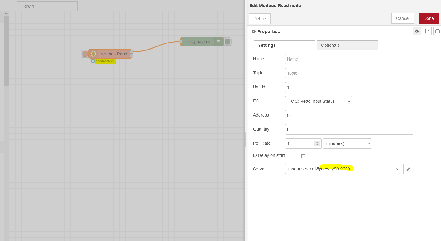

Steps that I did:
  1. Installed Raspbian Lite
  2. Installed Docker
  3. Installed Portainer
  4. Permissions for /dev/ttyS0 - sudo chmod 666 /dev/ttyS0
  5. Deployed Node-RED container
  6. Installed modbus module
  7. Did configure modbus Read node and deployed it
The node is connected to the serial but when I try to read data from it it returns error - Modbus Failure On State sending Get More About It By Logging
I connect CM4 RS485 port to relay port as it is shown in video and try to read relay statuses.
Update:
After I switch to USB-RS485 adapter everything works fine.

I installed the full Raspbian OS x64 (with desktop) and still cannot read data using integrated RS485 port (the error is same) Sad
I installed NODE-RED locally (without docker) and the results are same.
  • /dev/ttyUSB0 - modbus is working fine
  • /dev/ttyS0 - error: Modbus Failure On State sending Get More About It By Logging

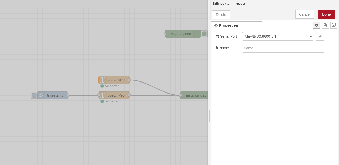

there is information about this in node-red forum: https://discourse.nodered.org/t/modbus-f...ng/53942/8
i suggest you use "serial" node to test firstly, not need "modbus" node test firstly. so that can confirm whether hardware serial is enabled.

The serial port is connected, could u please send me a command that I can use for testing. For example read relays statuses or turn on/off single relay.
