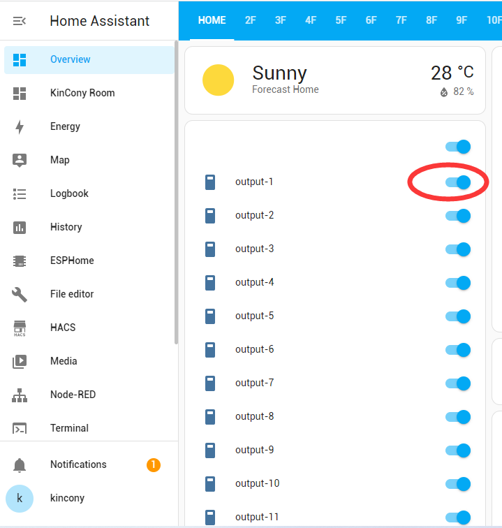

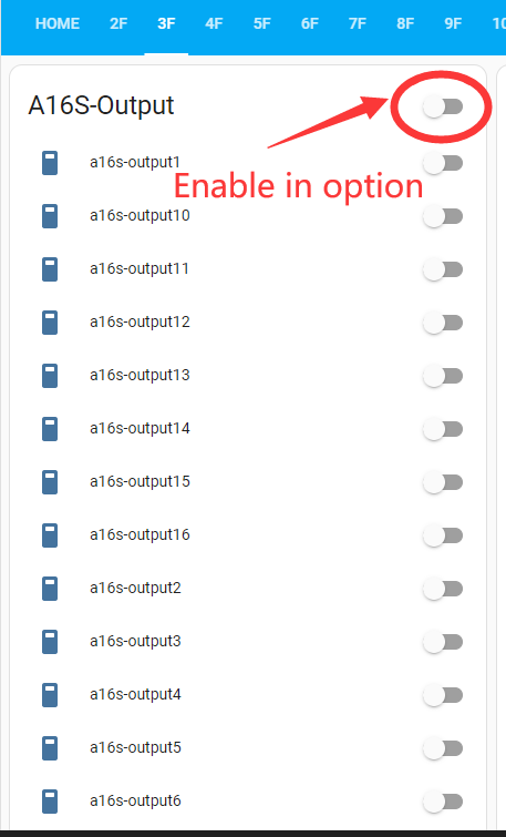

if you use home assistant, just ENABLE the ALL ON/OFF switch on dashboard. click "edit" card, then you will see the TOGGLE button option, just enable it.
this button for conrol ALL ON/OFF.

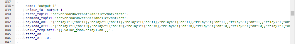

I tried as you mentioned. But only relay 1 comes on. I believe it has something to do with the following command.
value_template: '{{ value_json.relay1.on }}' Can you please check this out? switch: - name: 'output-1' unique_id: output-1 state_topic: 'relay32/99f9caa4068e7805b09f9a6a/state' command_topic: 'relay32/99f9caa4068e7805b09f9a6a/set' payload_on: '{"relay1":{"on":1},"relay2":{"on":1},"relay3":{"on":1},"relay4":{"on":1},"relay5":{"on":1},"relay6":{"on":1},"relay7":{"on":1},"relay8":{"on":1},"relay9":{"on":1},"relay10":{"on":1},"relay11":{"on":1},"relay12":{"on":1},"relay13":{"on":1},"relay14":{"on":1},"relay15":{"on":1},"relay16":{"on":1},"relay17":{"on":1},"relay18":{"on":1},"relay19":{"on":1},"relay20":{"on":1},"relay21":{"on":1},"relay22":{"on":1},"relay23":{"on":1},"relay24":{"on":1},"relay25":{"on":1},"relay26":{"on":1},"relay27":{"on":1},"relay28":{"on":1},"relay29":{"on":1},"relay30":{"on":1},"relay31":{"on":1},"relay32":{"on":1}}' payload_off: '{"relay1":{"on":0},"relay2":{"on":0},"relay3":{"on":0},"relay4":{"on":0},"relay5":{"on":0},"relay6":{"on":0},"relay7":{"on":0},"relay8":{"on":0},"relay9":{"on":0},"relay10":{"on":0},"relay11":{"on":0},"relay12":{"on":0},"relay13":{"on":0},"relay14":{"on":0},"relay15":{"on":0},"relay16":{"on":0},"relay17":{"on":0},"relay18":{"on":0},"relay19":{"on":0},"relay20":{"on":0},"relay21":{"on":0},"relay22":{"on":0},"relay23":{"on":0},"relay24":{"on":0},"relay25":{"on":0},"relay26":{"on":0},"relay27":{"on":0},"relay28":{"on":0},"relay29":{"on":0},"relay30":{"on":0},"relay31":{"on":0},"relay32":{"on":0}}' value_template: '{{ value_json.relay1.on }}' state_on: 1 state_off: 0
i have tested , no any problem. this is sample config for turn ON 16CH relay and turn OFF 16CH relay by "output-1" button in dashboard.
- name: 'output-1' unique_id: output-1 state_topic: 'server/8ae082ec66f37db231cf2b8f/state' command_topic: 'server/8ae082ec66f37db231cf2b8f/set' payload_on: '{"relay1":{"on":1},"relay2":{"on":1},"relay3":{"on":1},"relay4":{"on":1},"relay5":{"on":1},"relay6":{"on":1},"relay7":{"on":1},"relay8":{"on":1},"relay9":{"on":1},"relay10":{"on":1},"relay11":{"on":1},"relay12":{"on":1},"relay13":{"on":1},"relay14":{"on":1},"relay15":{"on":1},"relay16":{"on":1}}' payload_off: '{"relay1":{"on":0},"relay2":{"on":0},"relay3":{"on":0},"relay4":{"on":0},"relay5":{"on":0},"relay6":{"on":0},"relay7":{"on":0},"relay8":{"on":0},"relay9":{"on":0},"relay10":{"on":0},"relay11":{"on":0},"relay12":{"on":0},"relay13":{"on":0},"relay14":{"on":0},"relay15":{"on":0},"relay16":{"on":0}}' value_template: '{{ value_json.relay1.on }}' state_on: 1 state_off: 0 here is my config yaml file, you can compare, whether have syntax issue.
