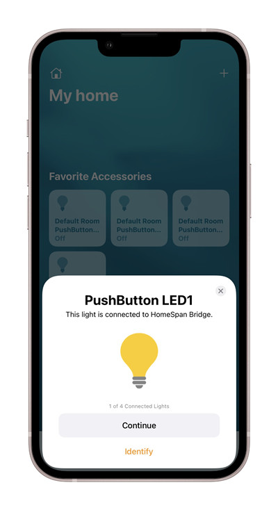

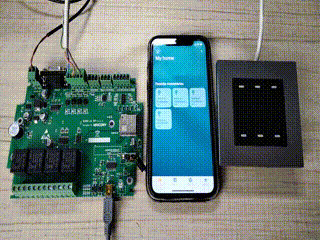

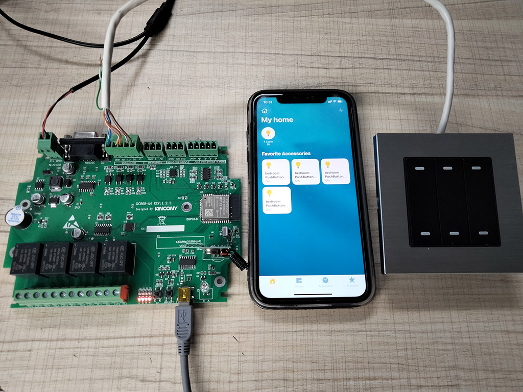

this arduino source code for KC868-A4 work with 4 relay and 4 momentary switch buttons via Apple homekit app. you can download the BIN firmware directly without chanage any code. Or you can open arduino source code project to compile.
here are KC868-A4 board with 6 gang switch panel (actually I have used 4 buttons) and iPhoneXR.

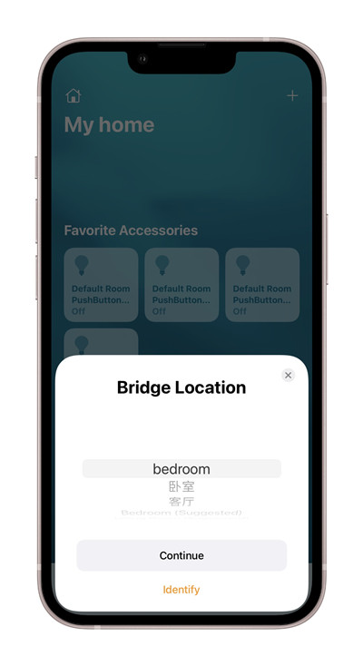

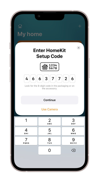

after you downloaded firmware, first time to use, need type "W" in serial monitor, chose number of wifi SSID, input password.
then use your iPhone or iPad to pair KC868-A4.
