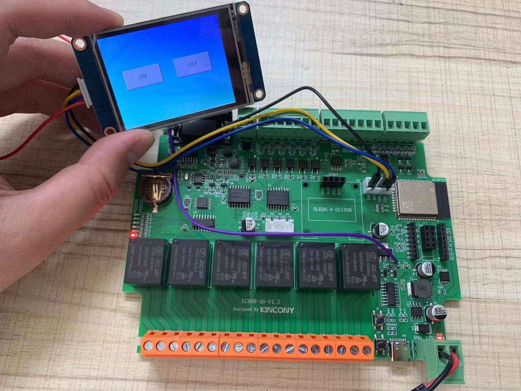

Nextion display work with KC868-A6
i have used on board extend serial port. actually use want to use VCC,GND,RXD,TXD for Nextion display.
define RXD:GPIO13 TXD:GPIO12 by ESP32
weld Vcc 5V from LM1117 output pin.
here are some photos:
This just a simplest demo, use Nextion display two buttons, press button-one will send 'a' by serial port, press button-two will send 'b' by serial port.
when KC868-A4 received 'a' will turn ON relay1, when received 'b' will turn OFF relay1.
firstly create two buttons UI by Nextion Editor PC software:
[Image: attachment.php?aid=1429]
[Image: attachment.php?aid=1430]
here is firmware BIN file, you can download to KC868-A4 ESP32 directly to use:
.zip   nextion_KC868-A6.ino.nodemcu-32s.zip (Size: 108.86 KB / Downloads: 524)
here are source code:

Hello, put a 3V3 converter so that the RX and TX ports (io12 io13) communicate correctly with nextion to the 5V converter, which could damage the board you produced with so much affection. Note that the communication failed because I need to remove the wire connected to the RX and then plug it in for my project to work. how do i solve this?
Thanks!
why damage? your Nextion display connect to KC868-A6's pin directly is ok, just do as photo. Nextion display serial port support 3.3v level.
To turn on the nextion monitor, it was necessary to feed it with 5V. These pins of the kincony A6 board would ideally receive 3.3V
Why was there no concern with the voltage applied to make an RX TX communication from the monitor to pins A12 and A13 of the kincony A6 board?
The communication of both is being 5V. Correct me if I reached the wrong conclusion.
we alreeady have post the photo, it's work fine. your question is no problem.
