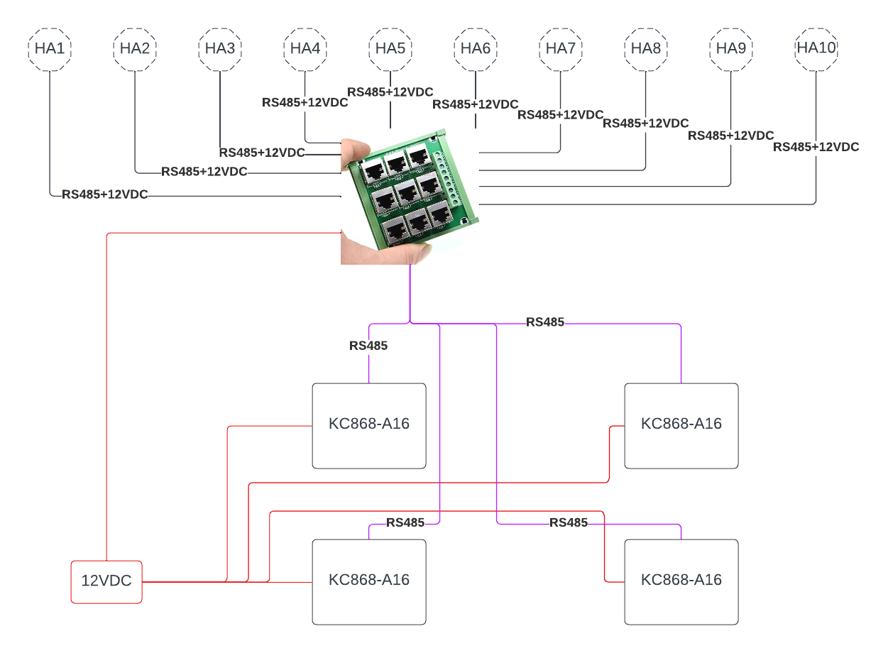

Is it possible to use 4x KC868-A16 and 10+ on the same modbus (RS485) line?
I want to use the KCS firmware

can you draw a diagram post at here.
do you want multi KC868-A16 connect together with RS485, control by PC or another device? sorry, i don't understand what you want to do.

sure, it can work, because every KC868-HA can set different RS485 address by PC config software. every KC868-A serles relay board can set different RS485 address by config webpage via KCS firmware.
