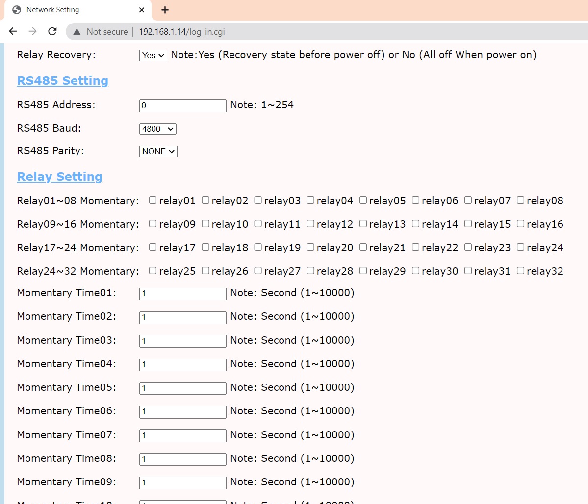

1. can you take a screen photo of your network setting webpage? i want to see your H32BS firmware version and how you set in relay recovery option.

I'm sending 6 pictures. First 4 pictures with all my settings, picture no.5 is home assistant error log from mqtt (H32BS) and picture no.6 is one of my wall switches.

if you want use 1-32 DI with mqtt message, please make sure "SW trigger output" is disable, now i seen in your screen photo, it's "enable".
