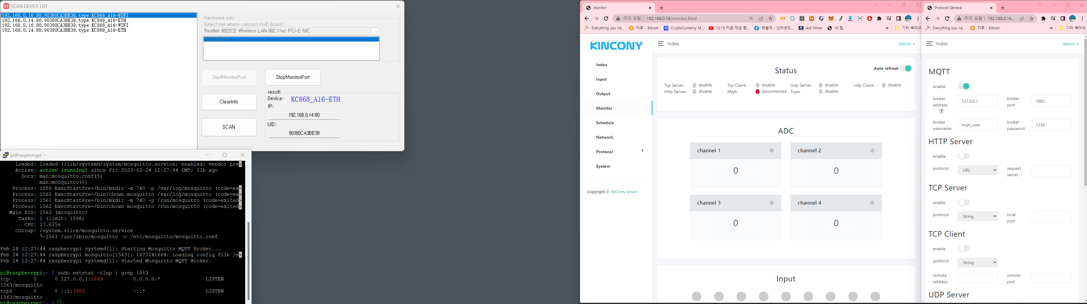

“KCS” means “KinCony Super” , this is a new firmware developed by KinCony for KC868-A series products in 2023. It has powerful functions and supports multiple communication protocols. It can manage various functions of the device through web pages, such as: input configuration, output configuration, monitoring management page, Timing schedule task mode, network configuration, communication protocol configuration, system configuration and other related functions
![[Image: index.png]](https://www.kincony.com/images/KCS/index.png)
Input configuration:
Binding of digital input port and output port, setting of effective value of high and low level, support multiple trigger modes through digital input port, such as: single click, double click, hold on mode
Output configuration:
Output level invert, support delay auto off, support jog mode control, support interlock setting
monitoring management page:
Monitor the status of the input in real time through the web page, and manually control the output
Timing schedule task mode:
Support custom scheduled tasks by year, month, day, hour, minute
Network Configuration:
configuration of ethernet and wifi
Communication protocol configuration:
Support MQTT, HTTP, TCP Server, TCP Client, UDP Server, UDP Client, Modbus multiple communication protocols
Tuya App configuration:
Configure Tuya app license to remote control board by internet
System Configuration:
default parameter settings
![[Image: input.png]](https://www.kincony.com/images/KCS/input.png)
![[Image: output.png]](https://www.kincony.com/images/KCS/output.png)
![[Image: monitor.png]](https://www.kincony.com/images/KCS/monitor.png)
![[Image: schedule.png]](https://www.kincony.com/images/KCS/schedule.png)
![[Image: network.png]](https://www.kincony.com/images/KCS/network.png)
![[Image: protocol.png]](https://www.kincony.com/images/KCS/protocol.png)
![[Image: tuya.png]](https://www.kincony.com/images/KCS/tuya.png)
![[Image: system.png]](https://www.kincony.com/images/KCS/system.png)
