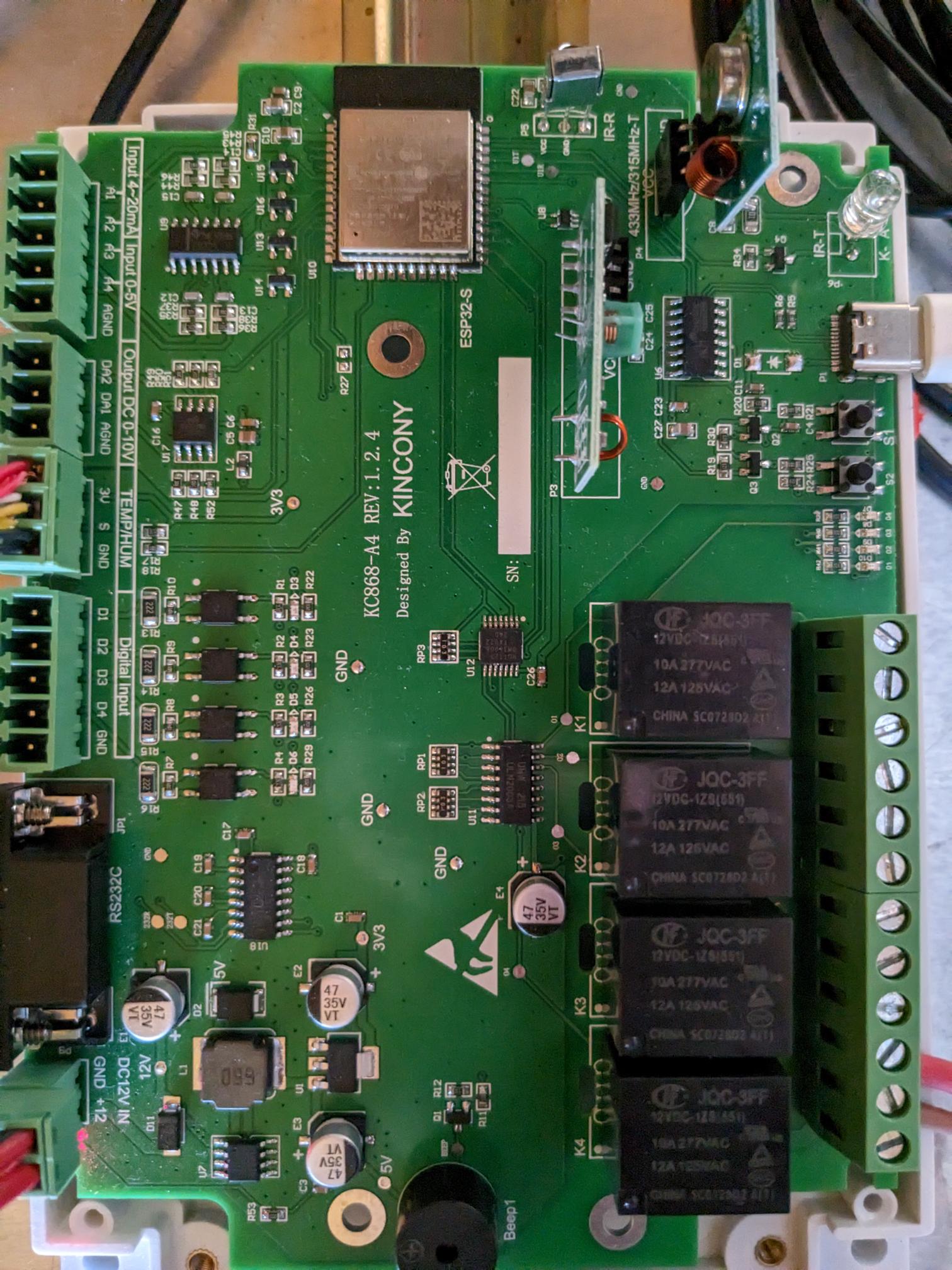

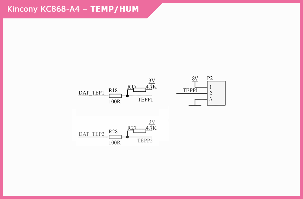

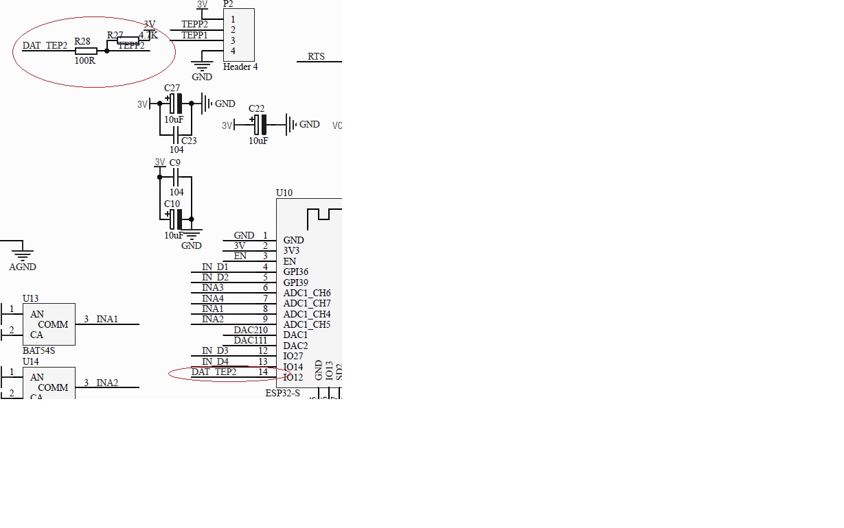

I have started to do more intensive use of the A4 board and I went to connect the second TEMP connection shown on circuit to find it was not connected. I can see why it was changed - to add 3V3 which is important however I do not have an up to date circuit diagram.
The circuit diagram I have for A4 is: https://www.kincony.com/download/KC868-A4-schematic.pdf
I would like an updated drawing if possible.
