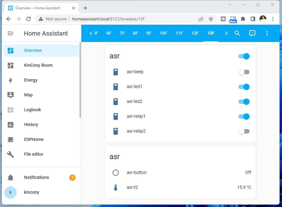

KC868-ASR ESPHome demo config for home assistant
esp32:
  board: esp32dev
  framework:
    type: arduino
# Enable Home Assistant API
  encryption:
    key: "Xqy9f8iJ49cr7o8IWE1sFnG9EAEnxHVYlGUQBdnKE6Q="
ota:
  password: "d13799179d079d89758ad1a0fd1c4560"
wifi:
  ssid: KinCony
  password: a12345678
  ap:
    ssid: "Asr Fallback Hotspot"
    password: "KqbpeFnrzcWf"
captive_portal:
i2c:
  sda: 26
  scl: 27
  scan: true
  - platform: gpio
    pin: GPIO19
  - platform: gpio
    pin: GPIO5
  - platform: gpio
    pin: GPIO23
  - platform: gpio
    pin: GPIO22
  - platform: gpio
    pin: GPIO18
binary_sensor:
  - platform: gpio
    pin:
      number: 0
      inverted: true
dallas:
  - pin: 32
    update_interval: 5s
sensor:
  - platform: dallas
    address: 0x7b062162cfe98128
.txt   KC868-ASR_ESPHome.txt (Size: 1.1 KB / Downloads: 614)
