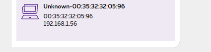

The First Moment After Updating my H32W everything was fine.
 i introduced the MQTT Settings and after a restart the device is no more reachable and it also don´t connect to the MQTT Broker. The Configuration Web-Portal (in my case 192.168.1.56) is not Reachable to check the settings. Is it Possible the Reset the Device to Factory Settings? Thank You.
It seems to be Connected via Ethernet to My Router:

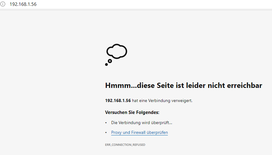

The Device Refuse Connection:
this firmware is for H32B, not for H32W, give me your email, I send you original firmware, you need to download again. Now only H32B support MQTT function.
