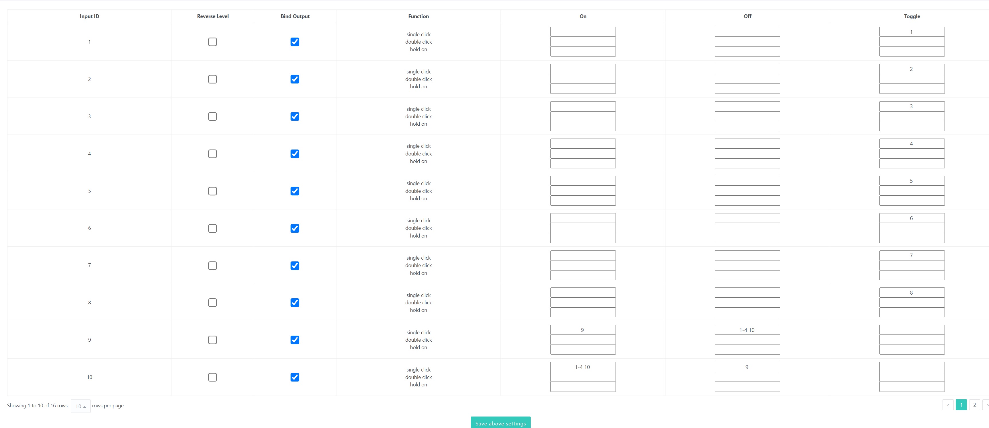

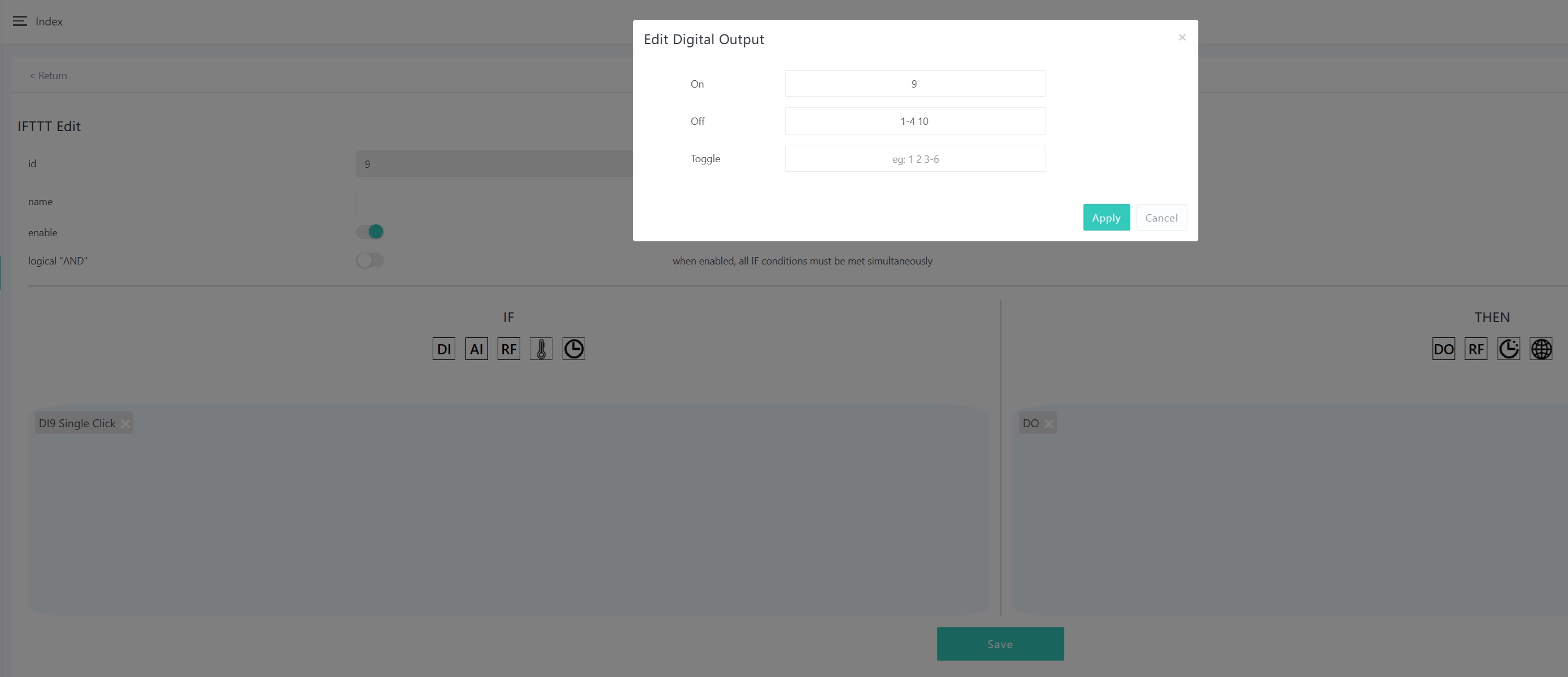

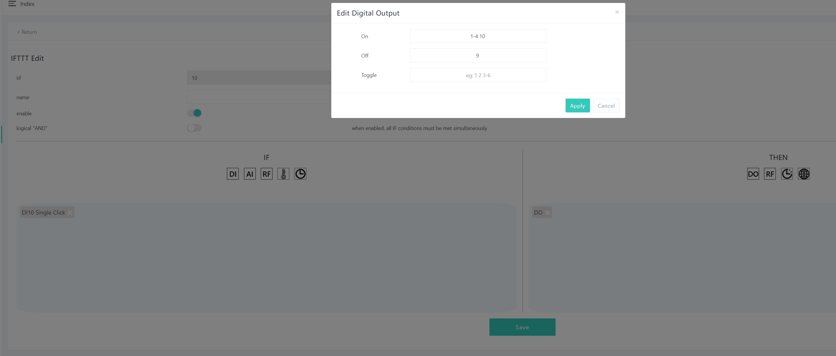

I have included images from v1.0.24 which works reliably and v2.2.2 which does not.
I have also included two videos as zip files. Every time the blue light changes, the inputs and outputs should change. KCS v1.0.24 shows that is works reliably, KCS v2.2.2 shows that it misses state changes fairly regular.
.zip   KCS v1.0.24 compressed.zip (Size: 6.57 MB / Downloads: 118)
.zip   KCS v2.2.2 Compressed.zip (Size: 8.06 MB / Downloads: 112)
