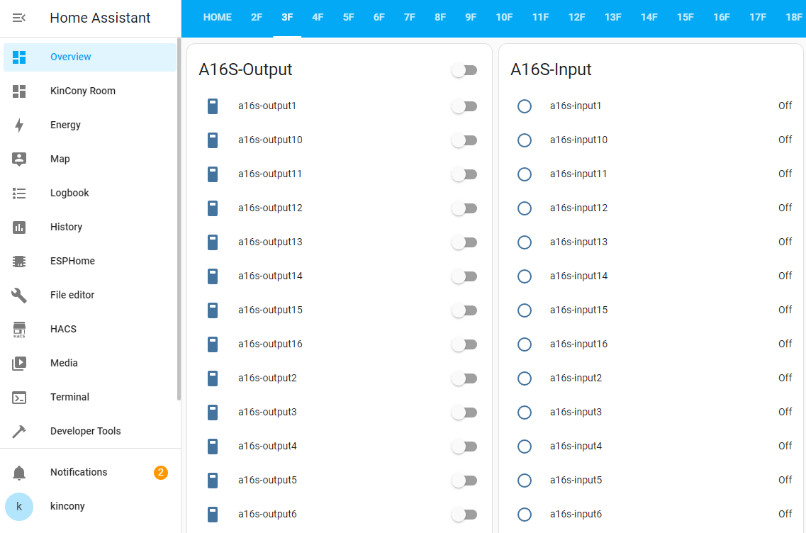

KC868-A16S configure yaml for ESPhome
  platform: ESP32
  board: esp32dev
i2c:
  sda: 4
  scl: 5
  scan: true
# Example configuration entry
ethernet:
  type: LAN8720
  mdc_pin: GPIO23
  mdio_pin: GPIO18
  clk_mode: GPIO17_OUT
  phy_addr: 0
  # Optional manual IP
#  manual_ip:
#    static_ip: 192.168.1.199
#    gateway: 192.168.1.1
#    subnet: 255.255.255.0
pcf8574:
    address: 0x24
    address: 0x25
    address: 0x22
    address: 0x23
# Individual outputs
  - platform: gpio
    pin:
      pcf8574: pcf8574_hub_out_1
      number: 0
      mode: OUTPUT
      inverted: true
  - platform: gpio
    pin:
      number: 1
      mode: OUTPUT
      inverted: true
  - platform: gpio
    pin:
      number: 2
      mode: OUTPUT
      inverted: true
  - platform: gpio
    pin:
      number: 3
      mode: OUTPUT
      inverted: true
  - platform: gpio
    pin:
      number: 4
      mode: OUTPUT
      inverted: true
  - platform: gpio
    pin:
      number: 5
      mode: OUTPUT
      inverted: true
  - platform: gpio
    pin:
      number: 6
      mode: OUTPUT
      inverted: true
  - platform: gpio
    pin:
      number: 7
      mode: OUTPUT
      inverted: true
  - platform: gpio
    pin:
      pcf8574: pcf8574_hub_out_2
      number: 0
      mode: OUTPUT
      inverted: true
  - platform: gpio
    pin:
      number: 1
      mode: OUTPUT
      inverted: true
  - platform: gpio
    pin:
      number: 2
      mode: OUTPUT
      inverted: true
  - platform: gpio
    pin:
      number: 3
      mode: OUTPUT
      inverted: true
  - platform: gpio
    pin:
      number: 4
      mode: OUTPUT
      inverted: true
  - platform: gpio
    pin:
      number: 5
      mode: OUTPUT
      inverted: true
  - platform: gpio
    pin:
      number: 6
      mode: OUTPUT
      inverted: true
  - platform: gpio
    pin:
      number: 7
      mode: OUTPUT
      inverted: true
binary_sensor:
  - platform: gpio
    pin:
      pcf8574: pcf8574_hub_in_1
      number: 0
      mode: INPUT
      inverted: true
  - platform: gpio
    pin:
      number: 1
      mode: INPUT
      inverted: true
  - platform: gpio
    pin:
      number: 2
      mode: INPUT
      inverted: true
  - platform: gpio
    pin:
      number: 3
      mode: INPUT
      inverted: true
  - platform: gpio
    pin:
      number: 4
      mode: INPUT
      inverted: true
  - platform: gpio
    pin:
      number: 5
      mode: INPUT
      inverted: true
  - platform: gpio
    pin:
      number: 6
      mode: INPUT
      inverted: true
  - platform: gpio
    pin:
      number: 7
      mode: INPUT
      inverted: true
  - platform: gpio
    pin:
      pcf8574: pcf8574_hub_in_2
      number: 0
      mode: INPUT
      inverted: true
  - platform: gpio
    pin:
      number: 1
      mode: INPUT
      inverted: true
  - platform: gpio
    pin:
      number: 2
      mode: INPUT
      inverted: true
  - platform: gpio
    pin:
      number: 3
      mode: INPUT
      inverted: true
  - platform: gpio
    pin:
      number: 4
      mode: INPUT
      inverted: true
  - platform: gpio
    pin:
      number: 5
      mode: INPUT
      inverted: true
  - platform: gpio
    pin:
      number: 6
      mode: INPUT
      inverted: true
  - platform: gpio
    pin:
      number: 7
      mode: INPUT
      inverted: true
# Enable Home Assistant API
.txt   Made_for_ESPHome_KC868-A16S.txt (Size: 5.63 KB / Downloads: 780)
