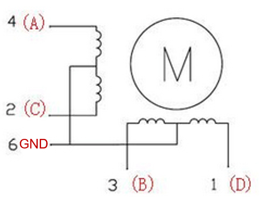

[Arduino source code for KC868-A8M]-07 Control 28BYJ-48 step motor
#include <RCSwitch.h>
#include "PCF8574.h"
#define motor_pin_1 0
#define motor_pin_2 1
#define motor_pin_3 2
#define motor_pin_4 3

/************Clockwise************/
void Clockwise_Turn (int Step)
  while (Step>0)
    int which_one=Step % 4;
        switch (which_one) {
         case 0:  // AB
          pcf8574.digitalWrite(motor_pin_1, HIGH);
          pcf8574.digitalWrite(motor_pin_2, HIGH);
          pcf8574.digitalWrite(motor_pin_3, LOW);
          pcf8574.digitalWrite(motor_pin_4, LOW);
        break;
        case 1:  // BC
          pcf8574.digitalWrite(motor_pin_1, LOW);
          pcf8574.digitalWrite(motor_pin_3, HIGH);
        break;
        case 2:  //CD
          pcf8574.digitalWrite(motor_pin_2, LOW);
          pcf8574.digitalWrite(motor_pin_4, HIGH);
        break;
        case 3:  //DA
        break;
    Read_buttonState();
    Button_speed_up_down();
    if (KEY2_BUTTON == 1)
      Anti_Clockwise_Turn(Turn_Step);
    if (KEY3_BUTTON == 1)
      Stop_Turn(Turn_Step);
    Step--;
    delay(Step_Dealy_Time);
