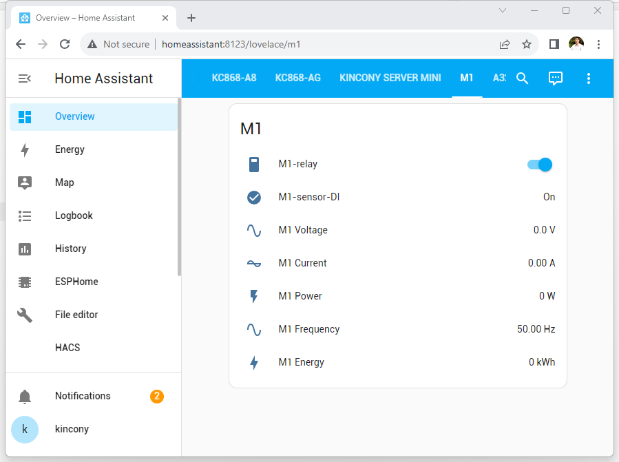

KinCony M1 configure yaml for ESPhome
.txt   M1-Home assistant.txt (Size: 865 bytes / Downloads: 211)
