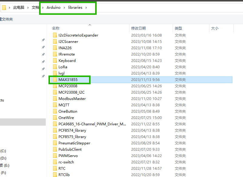

Install  easypcf8575  library
Unzip max31855.zip file and copy the file to arduino librarys
