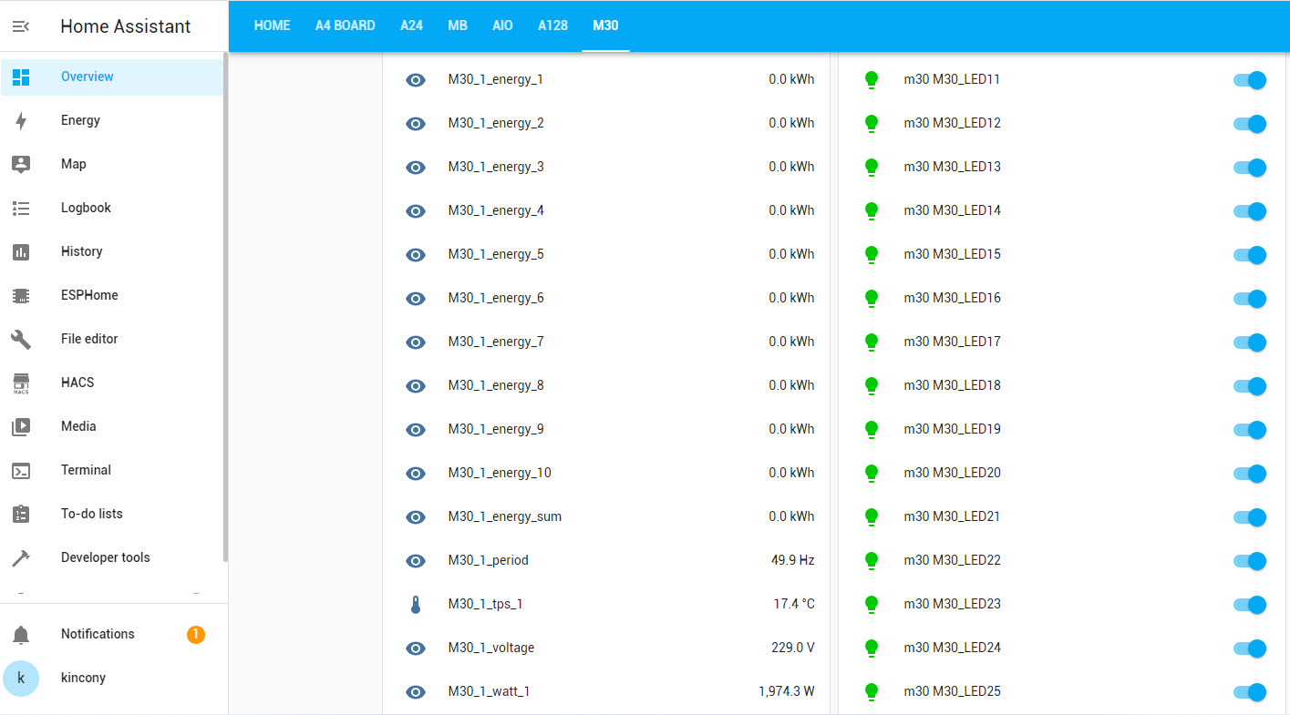

M30 configure yaml for ESPhome
yaml download:
.txt   M30_HA_LEDs.txt (Size: 49.87 KB / Downloads: 413)
modbus pull screen setting:

new yaml support add to "Energy" dashboard in home assistant.
.txt   M30_HA_LEDs.txt (Size: 51.65 KB / Downloads: 220)
When I try to upload this yaml, I get the error: "Wrong Magic Byte".
upload your yaml file at here.
It is exactly the same file uploaded above - I have not made any changes.
you can contact by whatsapp number: +86-15381188302 when have free time, we can use ANYDESK remote control your computer to help you.
I think I've figured it out. There were two breaking changes in the yaml/compile step. One is the "ota" key requires "platform", and the other is the ota upload reqires a different bin file. (in .esphome/build/m30/.pioenvs/m30/firmware.ota.bin). so the yaml change needed is to change:
ota:
password: "2a26484203d80a83798414c879541760"
to:
ota:
platform: esphome
ok, good.
For the yaml lines:
  max_current_range1: "10"
Should the "10" be replaced with the max capacity of the CT clamp, or the capacity of the circuit?
For example, If I put a 25A CT clamp on a 15A circuit, should the yaml be "25" or "15"?
Within the yaml, I see these values are only used to compute the LED color, are they used in the firmware for anything?
"max_current_range1" only use for LED color, so that can change color for GREEN to RED. not used by firmware other function.
