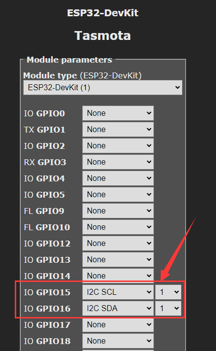

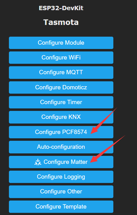

7. after re power on of ESP32 board, you can connect with tasmota, config it with I2C SDA and SCL pins firstly, then you can see the PCF8574 option and MATTER option.
