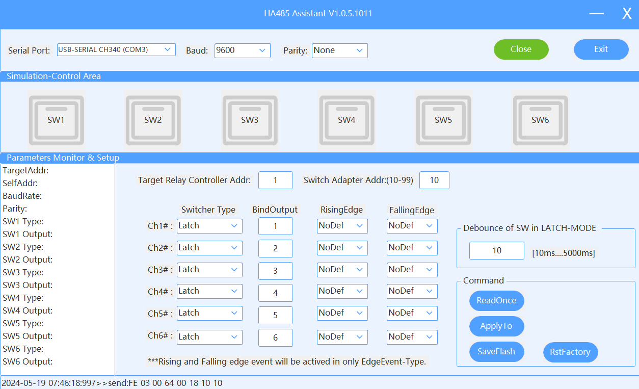

when HAv2 board power on , whether have RED led blink? that's running led .

when power on its blink fast fr few seconds and than blink slow after wards, I have two HAV2,both are doing same.
thanks dear for your support, I found issue with USB-RS485 convertor
