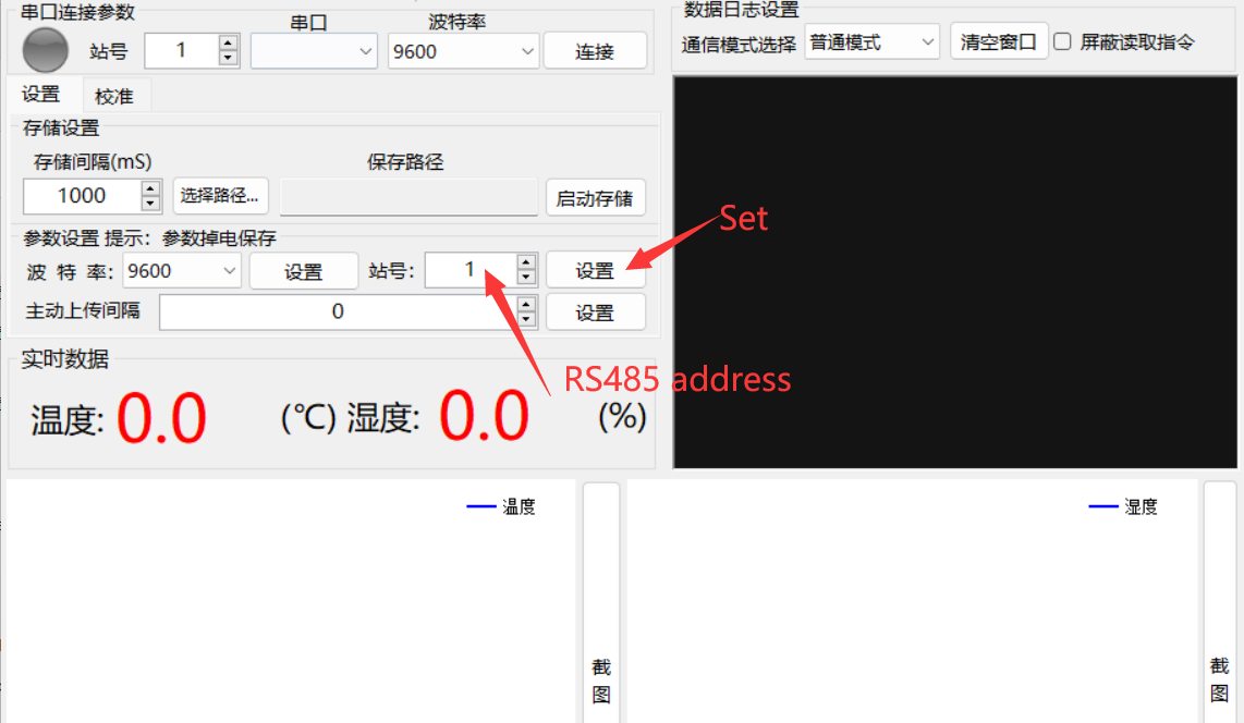

#13
use PC software to config the RS485 address. after click "set" button, then power off the sensor and power on again.
PC software download:
.zip   Debug.zip (Size: 4.08 MB / Downloads: 75)
#14
Finally, it is working. Thank you very much.
For anyone else trying to set an address without the provided software. You should set the address to registry `0x0a`.
