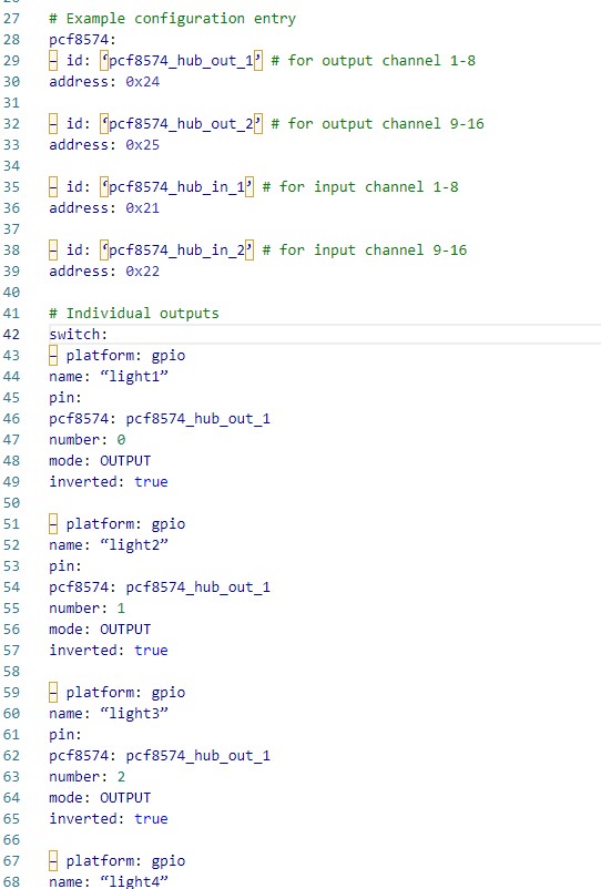

still getting this message from the esp home assist:  INFO ESPHome 2024.7.0
INFO Reading configuration /config/esphome/esphome-web-fe42e8.yaml...
ERROR Error while reading config: Invalid YAML syntax:
Duplicate key "– id"
  in "/config/esphome/esphome-web-fe42e8.yaml", line 32, column 1
NOTE: Previous declaration here:
  in "/config/esphome/esphome-web-fe42e8.yaml", line 29, column 1
the code is good until here:
# Example configuration entry
pcf8574:
– id: ‘pcf8574_hub_out_1’ # for output channel 1-8              this is line 29
address: 0x24
– id: ‘pcf8574_hub_out_2’ # for output channel 9-16
address: 0x25
– id: ‘pcf8574_hub_in_1’ # for input channel 1-8                this is line 32
address: 0x21
– id: ‘pcf8574_hub_in_2’ # for input channel 9-16
address: 0x22
# Individual outputs
– platform: gpio
pin:
pcf8574: pcf8574_hub_out_1
number: 0
mode: OUTPUT
inverted: true
INFO ESPHome 2024.7.0 INFO ESPHome 2024.7.0
you can download this file to use:
.txt   ESPHome_A16.txt (Size: 1.67 KB / Downloads: 406)
because if you copy and paste from webpage directly, there will have problem.
