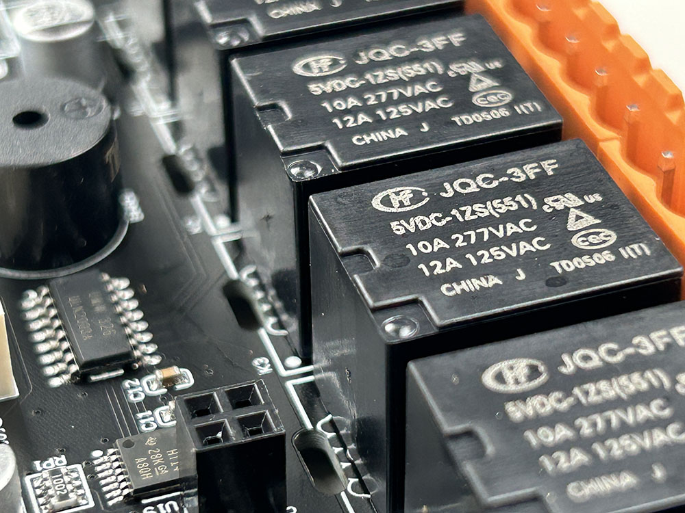

I'm thinking of using either KC868-A16S or KC868-A8S to control 24V lights/devices in a campervan via ESP32 with momentary switches and via a smartphone. Both boards indicate they handle AC current. Can they also handle DC 12v and/or 24v loads with the built in relays? If so, what is the max amps per relay and in total? What is the make/model/part number of the relay switch used on the board?

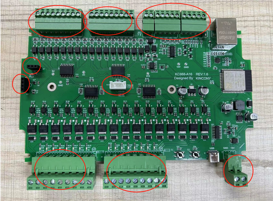

Thanks so much for the quick reply. Can you use a RF433Mhz sender/transmitter with the KC868-A8S? I only see a plug in for a RF433Mhz receiver. I see that the KC868-A8 appears to have plug ins for the sender/transmitter. Does the KC868-A8 use the same relays as the KC868-A8S?

KC868-A8S only have 433MHz receiver, without RF sender.
Does the KC868-A8 use the same relays as the KC868-A8S? -->Yes

The pictures of the KC868-A16 show that the RF sender/receiver and the I2C don't have sockets. Is the correct? If so, is it possible to get the board with the sockets soldered on?
