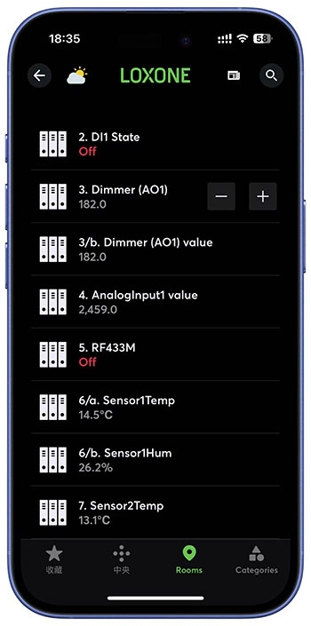

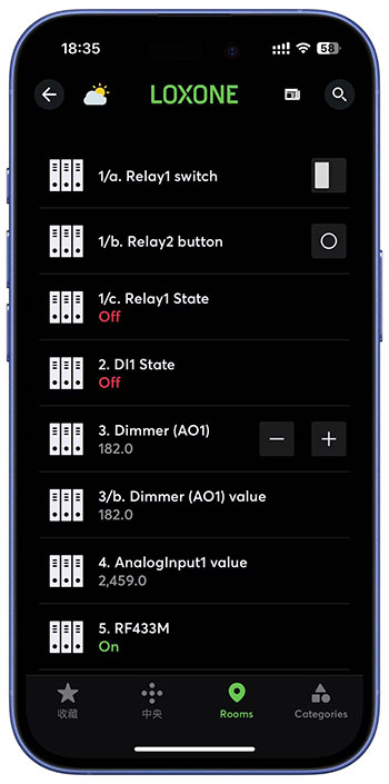

about demo function list:
1/a. Relay1 switch: you can trun ON/OFF relay1
1/b. Relay2 button: hold on the button relay2 is ON, release finger, relay2 is OFF. Usually use for curtain.
1/c. Relay1 State: feedback relay1's newest state, even if relay control by other ways, such as home assistant, tuya app, web browser, wall switch.
2. DI1 State: monitor digital input1 state.

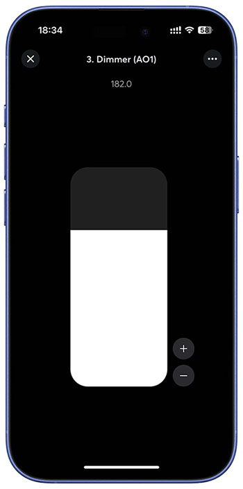

3. Dimmer (AO1): dimmer output with channel1 (range 0--255)
4. feedback AO1's newest state, even if dimmer control by other ways, such as home assistant, tuya app, web browser, wall switch.
5. RF433M: monitor RF433MHz sensor state for ON/OFF
6/a. Sensor1Temp: one temperature & humidity sensor's temperature value
6/b. Sensor1Hum: one temperature & humidity sensor's humidity value
7.Sensor2Temp: one temperature sensor's temperature value
