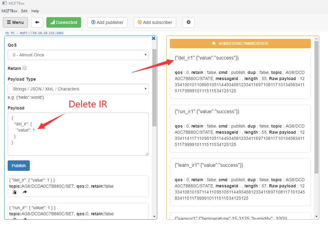

for IR commands:
you need to download KCS v3 firmware to ESP32-S3 firstly.
Different board will have different channel of digital output, digital input , ADC, DAC,IR, RF. So the protocol is same , just according to the hardware resource to set channel number.
protocol document download:
for IR commands:
