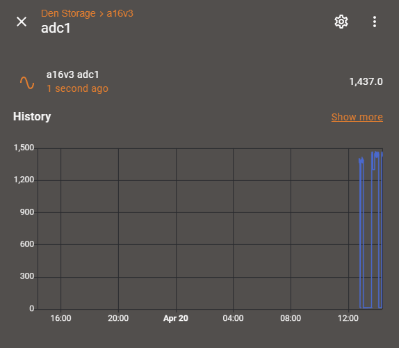

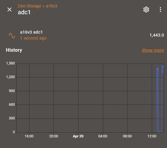

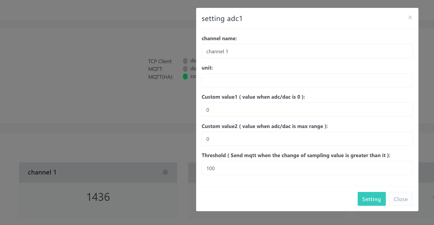

Hi. Does the ADC threshold not apply to Home Assistant MQTT? For testing, my CH1 is around 1430 to 1450, value does not go above 1450. I put 100 so it should update in MQTT the value when it go above 1500 correct? But in Home Assistant MQTT the value still update every 2 second between 1430 to 1450.
The drop in the graph is when I try reboot the board to see if threshold apply after reboot. Still same.

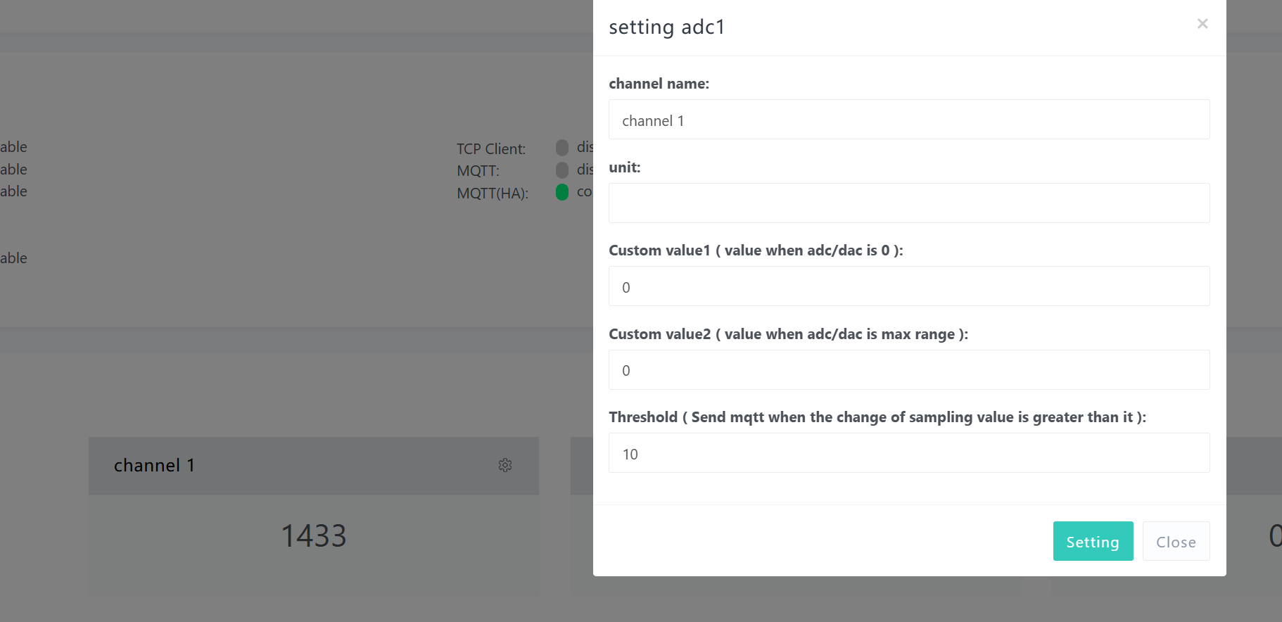

you can replace "100" with "10". have a testing.
Still same update every 1-2 second
