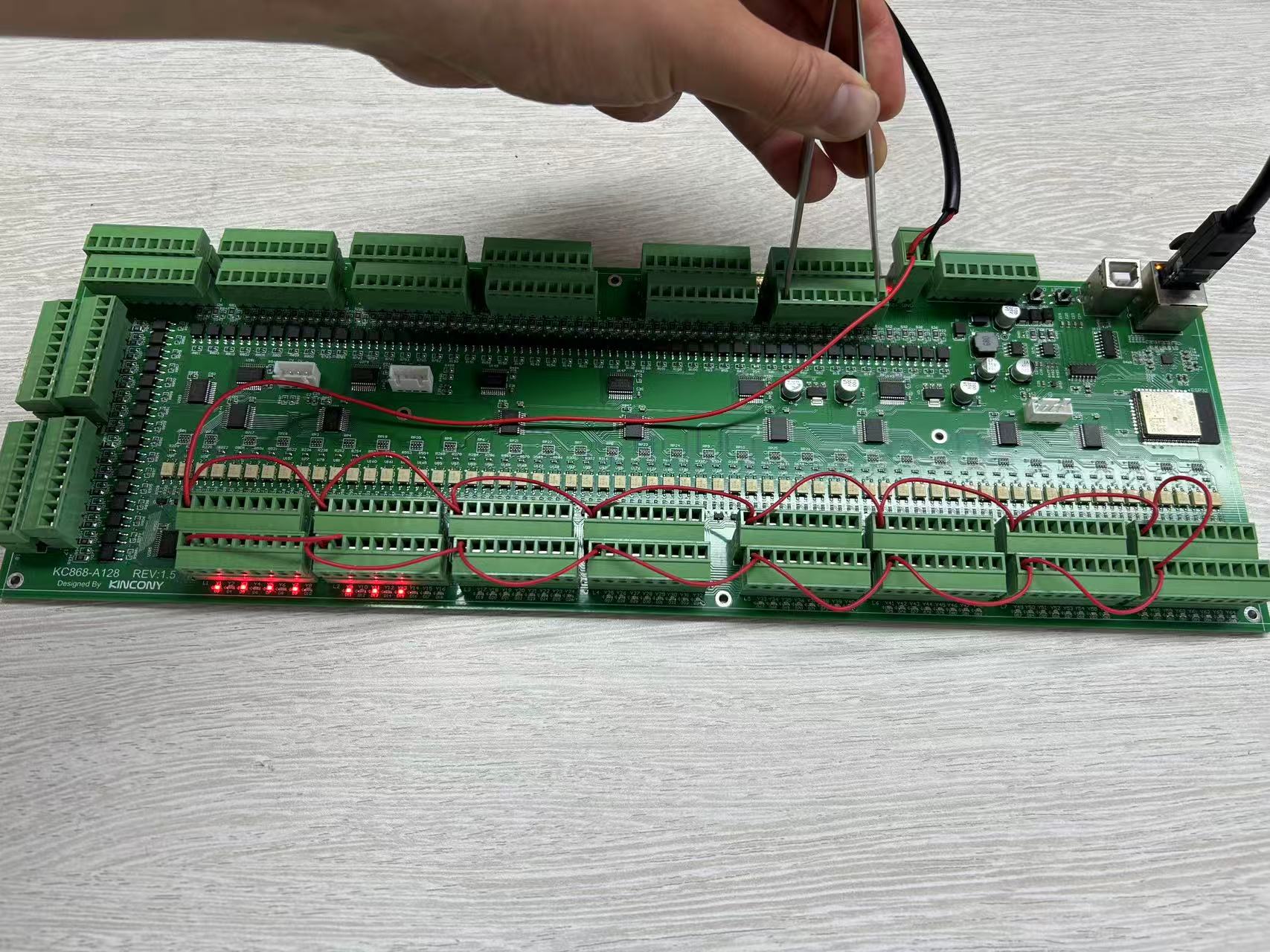

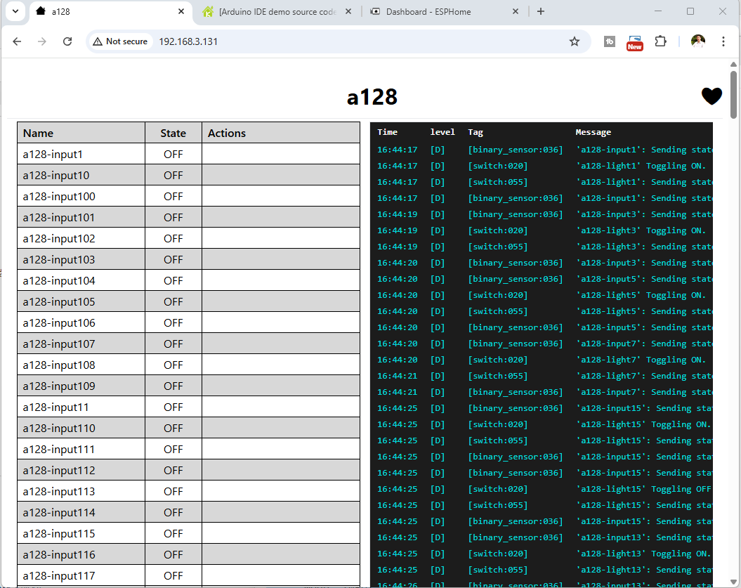

KC868-A128 INPUT toggle OUTPUT ESPhome yaml
  friendly_name: a128
