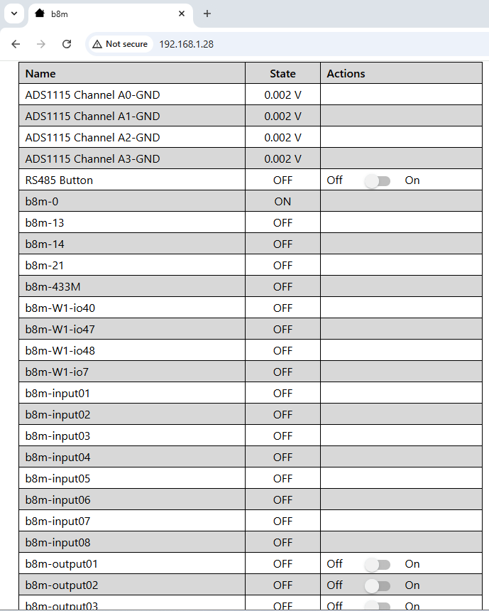

B8M ESPHome yaml for home assistant with tuya
  friendly_name: b8m
  platformio_options:
    board_build.extra_flags:
      # WIFI_CONTROL_SELF_MODE = 0
      # WIFI_CONTROL_SELF_MODE = 1
esp32:
  board: esp32-s3-devkitc-1
  framework:
    type: arduino
external_components:
  - source:
      type: git
      ref: v1.1.0
# logger:
#   hardware_uart: USB_SERIAL_JTAG
# Enable Home Assistant API
  encryption:
    key: "WeVOuL5oNhjXcfzXtTirlOwvtWvCD5yqIxd3oV4es1k="
ethernet:
  type: W5500
  clk_pin: GPIO1
  mosi_pin: GPIO2
  miso_pin: GPIO41
  cs_pin: GPIO42
  interrupt_pin: GPIO43
  reset_pin: GPIO44
i2c:
   - id: bus_a
     sda: 8
     scl: 18
     scan: true
     frequency: 400kHz
pcf8574:
  - id: 'pcf8574_hub_out_1'  # for output channel 0-7| input channel 8-15
    i2c_id: bus_a
    address: 0x22
    pcf8575: true
uart:
  - id: uart_1    #RS485
    baud_rate: 9600
    debug:
      direction: BOTH
      dummy_receiver: true
      after:
        timeout: 10ms
    tx_pin: 39
    rx_pin: 38
  - id: tuya_mcu_uart
    tx_pin: GPIO16
    rx_pin: GPIO17
    baud_rate: 9600
tuya_wifi_mcu:
  # tuya mcu product id
  product_id: mje1l6yi62hlljcn
  uart_id: tuya_mcu_uart
  wifi_reset_pin: 28
  wifi_led_pin: 16
  - platform: uart
    uart_id: uart_1
    data: [0x11, 0x22, 0x33, 0x44, 0x55]
  - platform: gpio
    pin:
      pcf8574: pcf8574_hub_out_1
      number: 0
      mode: OUTPUT
      inverted: true
  - platform: tuya_wifi_mcu
    dp_id: 1
    # hide from homeassistant ui
    internal: true
    bind_switch_id: "b8m_output01"
  - platform: gpio
    pin:
      number: 1
      mode: OUTPUT
      inverted: true
    dp_id: 2
    internal: true
    bind_switch_id: "b8m_output02"
  - platform: gpio
    pin:
      number: 2
      mode: OUTPUT
      inverted: true
    dp_id: 3
    internal: true
    bind_switch_id: "b8m_output03"
  - platform: gpio
    pin:
      number: 3
      mode: OUTPUT
      inverted: true
    dp_id: 4
    internal: true
    bind_switch_id: "b8m_output04"
  - platform: gpio
    pin:
      number: 4
      mode: OUTPUT
      inverted: true
    dp_id: 5
    internal: true
    bind_switch_id: "b8m_output05"
  - platform: gpio
    pin:
      number: 5
      mode: OUTPUT
      inverted: true
    dp_id: 6
    internal: true
    bind_switch_id: "b8m_output06"
  - platform: gpio
    pin:
      number: 6
      mode: OUTPUT
      inverted: true
    dp_id: 101
    internal: true
    bind_switch_id: "b8m_output07"
  - platform: gpio
    pin:
      number: 7
      mode: OUTPUT
      inverted: true
    dp_id: 102
    internal: true
    bind_switch_id: "b8m_output08"
binary_sensor:
  - platform: gpio
    pin:
      number: 8
      mode: INPUT
      inverted: true
    dp_id: 111
    bind_binary_sensor_id: b8m_input01
    internal: true
  - platform: gpio
    pin:
      number: 9
      mode: INPUT
      inverted: true
    dp_id: 112
    bind_binary_sensor_id: b8m_input02
    internal: true
  - platform: gpio
    pin:
      number: 10
      mode: INPUT
      inverted: true
    dp_id: 113
    bind_binary_sensor_id: b8m_input03
    internal: true
  - platform: gpio
    pin:
      number: 11
      mode: INPUT
      inverted: true
    dp_id: 114
    bind_binary_sensor_id: b8m_input04
    internal: true
  - platform: gpio
    pin:
      number: 12
      mode: INPUT
      inverted: true
    dp_id: 115
    bind_binary_sensor_id: b8m_input05
    internal: true
  - platform: gpio
    pin:
      number: 13
      mode: INPUT
      inverted: true
    dp_id: 116
    bind_binary_sensor_id: b8m_input06
    internal: true
  - platform: gpio
    pin:
      number: 14
      mode: INPUT
      inverted: true
    dp_id: 117
    bind_binary_sensor_id: b8m_input07
    internal: true
  - platform: gpio
    pin:
      number: 15
      mode: INPUT
      inverted: true
    dp_id: 118
    bind_binary_sensor_id: b8m_input08
    internal: true
##pull-up resistance on PCB
  - platform: gpio
    pin:
      number: 47
      inverted: true
  - platform: gpio
    pin:
      number: 48
      inverted: true
  - platform: gpio
    pin:
      number: 7
      inverted: true
  - platform: gpio
    pin:
      number: 40
      inverted: true
## without resistance on PCB
  - platform: gpio
    pin:
      number: 13
      inverted:  false
  - platform: gpio
    pin:
      number: 14
      inverted:  false
  - platform: gpio
    pin:
      number: 21
      inverted:  false
  - platform: gpio
    pin:
      number: 0
      inverted:  false
ads1115:
  - address: 0x48
sensor:
  - platform: ads1115
    multiplexer: 'A0_GND'
    gain: 6.144
    resolution: 16_BITS
    name: "ADS1115 Channel A0-GND"
    update_interval: 5s
  - platform: ads1115
    multiplexer: 'A1_GND'
    gain: 6.144
    name: "ADS1115 Channel A1-GND"
    update_interval: 5s
  - platform: ads1115
    multiplexer: 'A2_GND'
    gain: 6.144
    name: "ADS1115 Channel A2-GND"
    update_interval: 5s
  - platform: ads1115
    multiplexer: 'A3_GND'
    gain: 6.144
    name: "ADS1115 Channel A3-GND"
    update_interval: 5s
web_server:
  port: 80
font:
  - file: "gfonts://Roboto"
display:
  - platform: ssd1306_i2c
    i2c_id: bus_a
    model: "SSD1306 128x64"
    address: 0x3C
    lambda: |-
      it.printf(0, 0, id(roboto), "KinCony B8M");
download yaml file:
.txt   B8M-HA.txt (Size: 8.42 KB / Downloads: 160)
