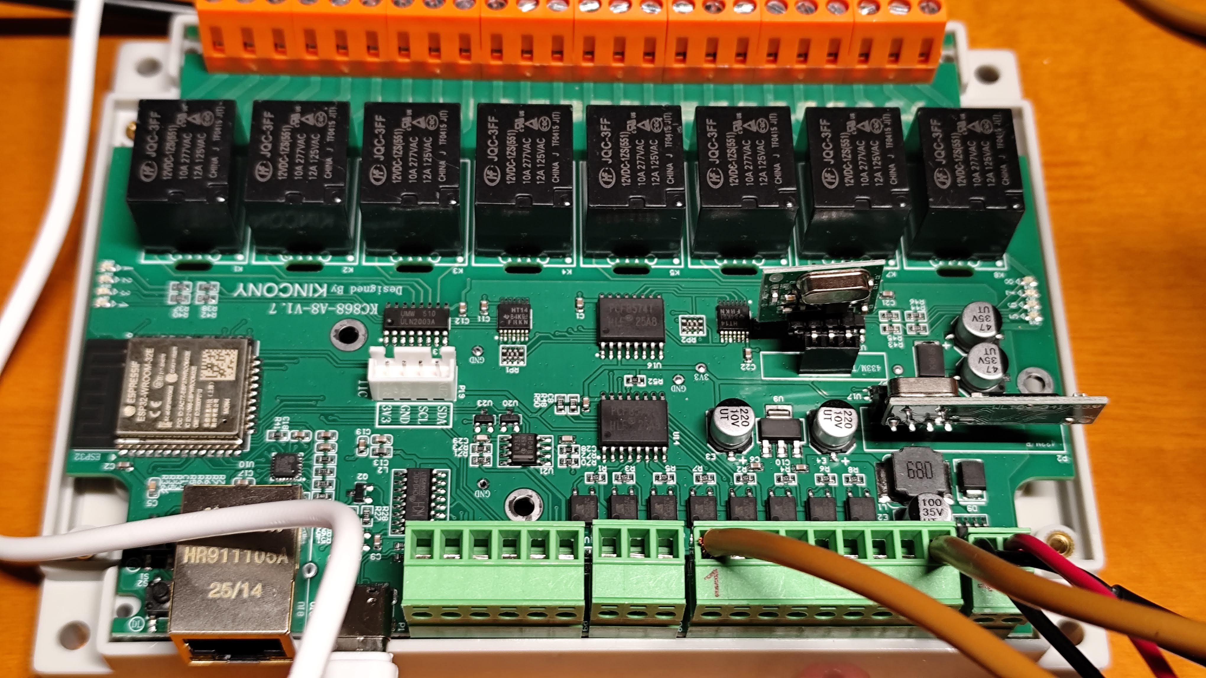

I have a new  KC868_A8
I bought to use it with Home Assistant input/output

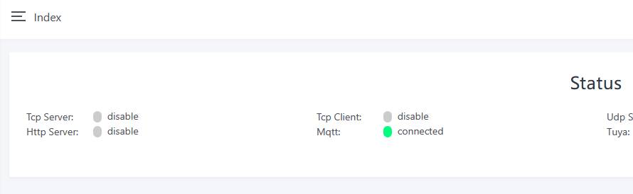

I set mqtt on the KC868_A8 as your guide and it works fine. Connection is done.

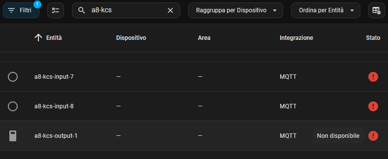

I have a problem on home assistant - it can find all the inputs/outputs but the are always unavailable. Can't work
Where is the problem?

the board is: KC868-A8-V1.7
