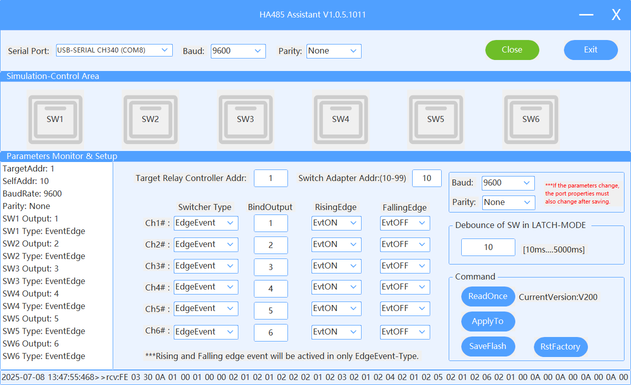

  # The binary_sensor corresponds to the state changes generated by K1~K6 on the KC868 HA board
  # bind_output is required. Corresponds to the BindOutput parameter in HA485_Ctrl software
  # Other parameters refer to: https://esphome.io/components/binary_sensor/index.html
  - platform: kc868_ha
    target_relay_controller_addr: 1 # Default value is 1, corresponds to the Target Relay Controller Addr parameter in HA485_Ctrl software
    switch_adapter_addr: 10 # Default value is 10, corresponds to the Switch Adapter Addr parameter in HA485_Ctrl software
    bind_output: 1 # Corresponds to the BindOutput parameter in HA485_Ctrl software

  # The switch is used to control the D1~D6 level output on the KC868 HA board
