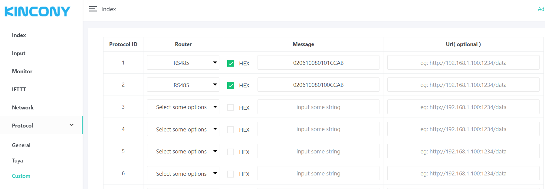

receive data from switch by RS485 and control output of KC868-A16
I try to find the way to control Output of KC868-A16.
I found the way to send information from KC868 but not on the other way.
Below a print screen of the way I used to do it.
and the link of data information
D8 Switch RS485
.pdf   D8 Switch RS485(XH)-Hotel polling-2022.12.16.pdf (Size: 619.95 KB / Downloads: 54)
you can config IF DI1 "RAISE EDGE" THEN send custom protocol1.
then use a RS485-USB adapter to monitor whether have sent.
(10-21-2025, 10:56 PM)admin Wrote: you can config IF DI1 "RAISE EDGE" THEN send custom protocol1.
Is it possible to config IF receive custom protocol1 THEN send DO1 "RAISE EDGE"?
that need KC868-A16v3 new board, use by KCS v3, KCS v3 support receive customize message as IF condition.
