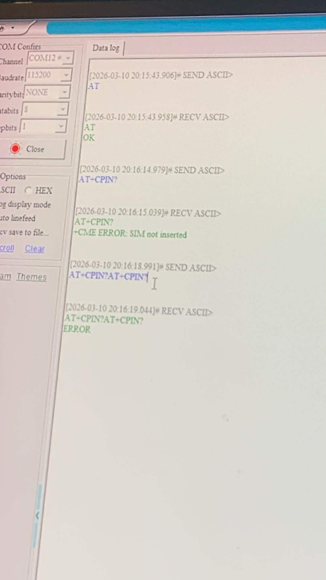

I actually just posted my thread here randomly because I didn't know how to create one my apologies, I am not using the E8T module, I am just having an error when it comes to my sim on the SIM7600 module. Is your sim in the video 4G?

(02-16-2026, 02:25 AM)admin Wrote: yes, EC200U-EU is 4G module.
Hi, sorry for the late reply.
This is the problem that I am still facing with the module.

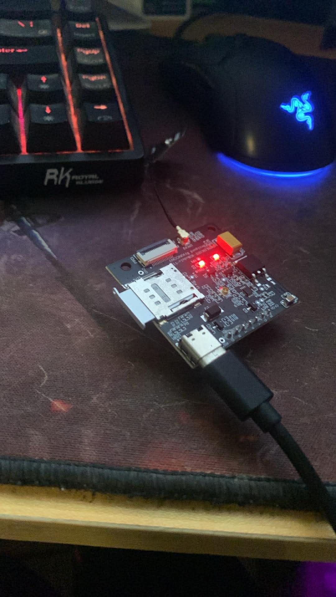

#15
you should add exend power supply, there is pins for power and GND. USB port current is low.
#16
(03-10-2026, 11:46 PM)admin Wrote: you should add exend power supply, there is pins for power and GND. USB port current is low.
Hi!, I tried adding a 5V power supply, but still the same.
#17
change another SIM card for a testing.
#18
(7 hours ago)admin Wrote: change another SIM card for a testing.
only 4G sim card?
#19
2G, 3G, 4G sim card all can use.
