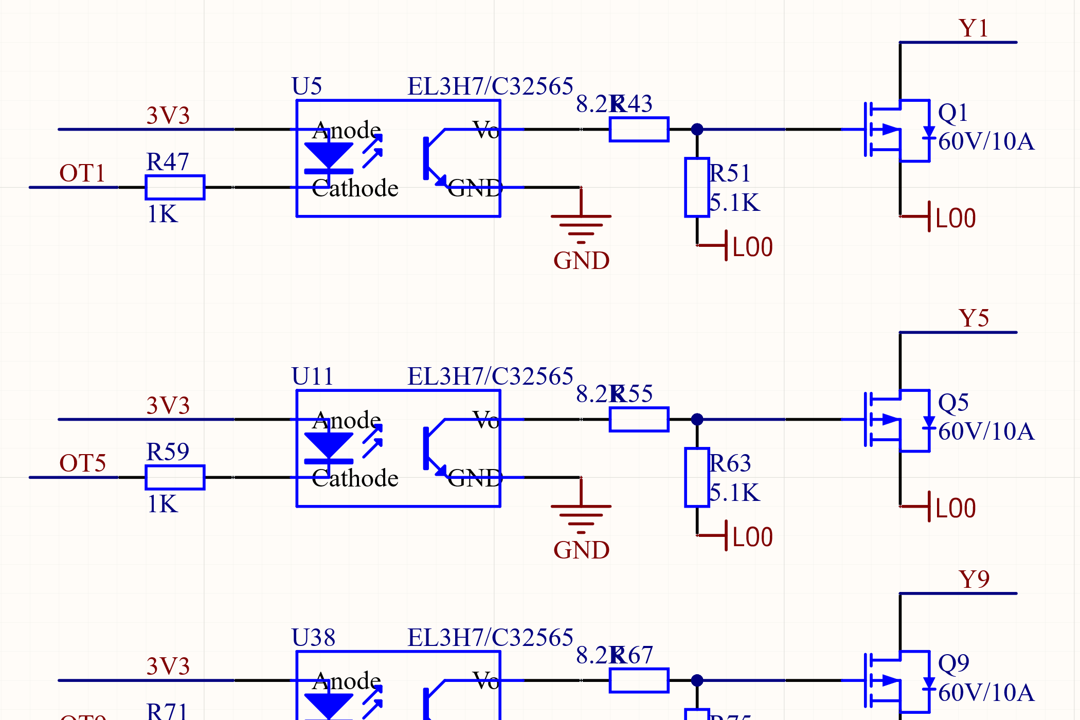

5. Do the outputs include built-in flyback diodes for inductive loads,
or do I need to add external flyback diodes for solenoid coils?

5. here is diagram of B24M output, T32M is same.
