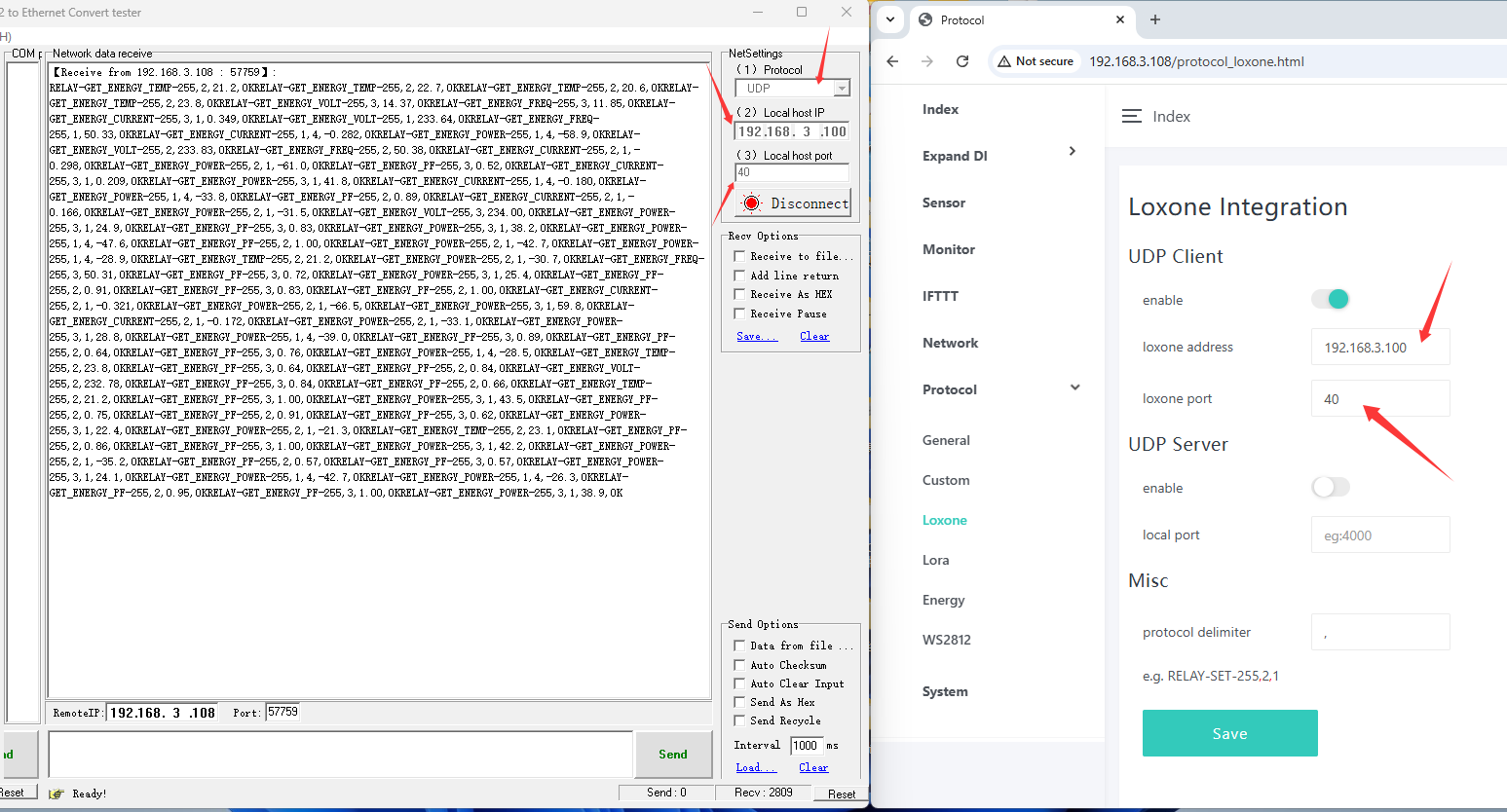

Overview
This document describes the Loxone string protocol for Energy module.
Default delimiter is comma (,). Chip ID: 1-6, Channel: 1-10.
Commands
1. GET_ENERGY_CURRENT - Get current (A) for specific channel
Request: RELAY-GET_ENERGY_CURRENT-255,{chip},{channel}
Response: RELAY-GET_ENERGY_CURRENT-255,{chip},{channel},{value},OK
Example:
Request: RELAY-GET_ENERGY_CURRENT-255,1,1
Response: RELAY-GET_ENERGY_CURRENT-255,1,1,2.350,OK
2. GET_ENERGY_POWER - Get power (W) for specific channel
Request: RELAY-GET_ENERGY_POWER-255,{chip},{channel}
Response: RELAY-GET_ENERGY_POWER-255,{chip},{channel},{value},OK
Example:
Request: RELAY-GET_ENERGY_POWER-255,1,1
Response: RELAY-GET_ENERGY_POWER-255,1,1,512.5,OK
3. GET_ENERGY_KWH - Get energy (kWh) for specific channel
Request: RELAY-GET_ENERGY_KWH-255,{chip},{channel}
Response: RELAY-GET_ENERGY_KWH-255,{chip},{channel},{value},OK
Example:
Request: RELAY-GET_ENERGY_KWH-255,1,1
Response: RELAY-GET_ENERGY_KWH-255,1,1,1250,OK
4. GET_ENERGY_VOLT - Get voltage (V) for chip
Request: RELAY-GET_ENERGY_VOLT-255,{chip}
Response: RELAY-GET_ENERGY_VOLT-255,{chip},{value},OK
Example:
Request: RELAY-GET_ENERGY_VOLT-255,1
Response: RELAY-GET_ENERGY_VOLT-255,1,220.50,OK
5. GET_ENERGY_FREQ - Get frequency (Hz) for chip
Request: RELAY-GET_ENERGY_FREQ-255,{chip}
Response: RELAY-GET_ENERGY_FREQ-255,{chip},{value},OK
Example:
Request: RELAY-GET_ENERGY_FREQ-255,1
Response: RELAY-GET_ENERGY_FREQ-255,1,50.00,OK
6. GET_ENERGY_TEMP - Get temperature © for chip
Request: RELAY-GET_ENERGY_TEMP-255,{chip}
Response: RELAY-GET_ENERGY_TEMP-255,{chip},{value},OK
Example:
Request: RELAY-GET_ENERGY_TEMP-255,1
Response: RELAY-GET_ENERGY_TEMP-255,1,35.5,OK
7. GET_ENERGY_PF - Get power factor for chip
Request: RELAY-GET_ENERGY_PF-255,{chip}
Response: RELAY-GET_ENERGY_PF-255,{chip},{value},OK
Example:
Request: RELAY-GET_ENERGY_PF-255,1
Response: RELAY-GET_ENERGY_PF-255,1,0.95,OK
8. GET_ENERGY_SUM - Get total energy (kWh) for chip
Request: RELAY-GET_ENERGY_SUM-255,{chip}
Response: RELAY-GET_ENERGY_SUM-255,{chip},{value},OK
Example:
Request: RELAY-GET_ENERGY_SUM-255,1
Response: RELAY-GET_ENERGY_SUM-255,1,12500,OK
protocol download:
Nx-energy_loxone_protocol.txt (Size: 2.34 KB / Downloads: 154)

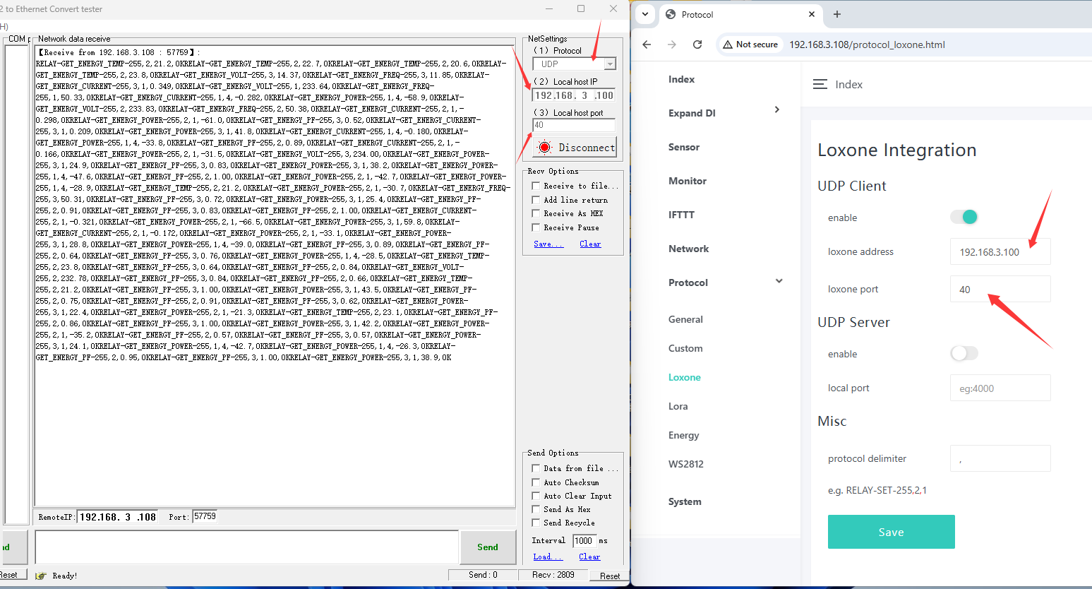

Overview
Commands
Example:
Example:
Example:
Example:
Example:
Example:
Example:
Example:
protocol download:
