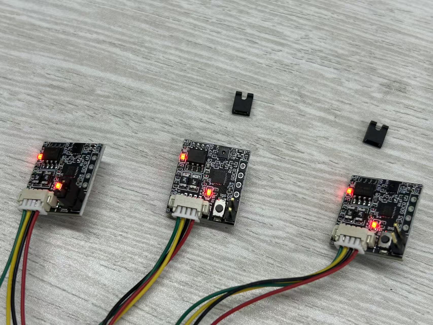

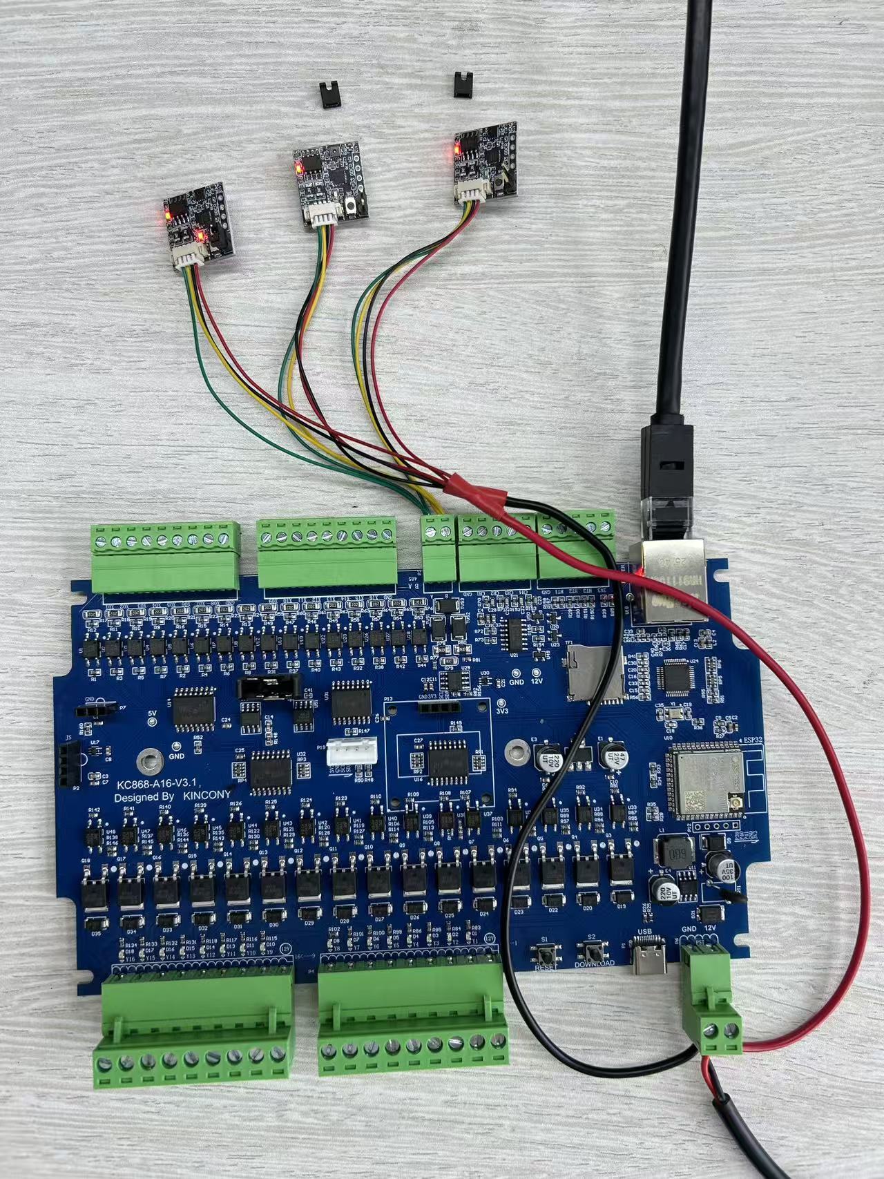

here is sample ESPHome yaml code for 3 TS together with one RS485 bus using KC868-A16v3 board.

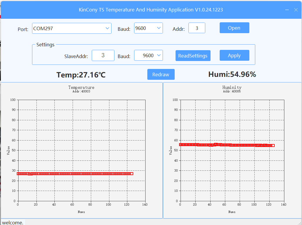

set every TS with different RS485 address by PC software, make sure PC software can read the data:

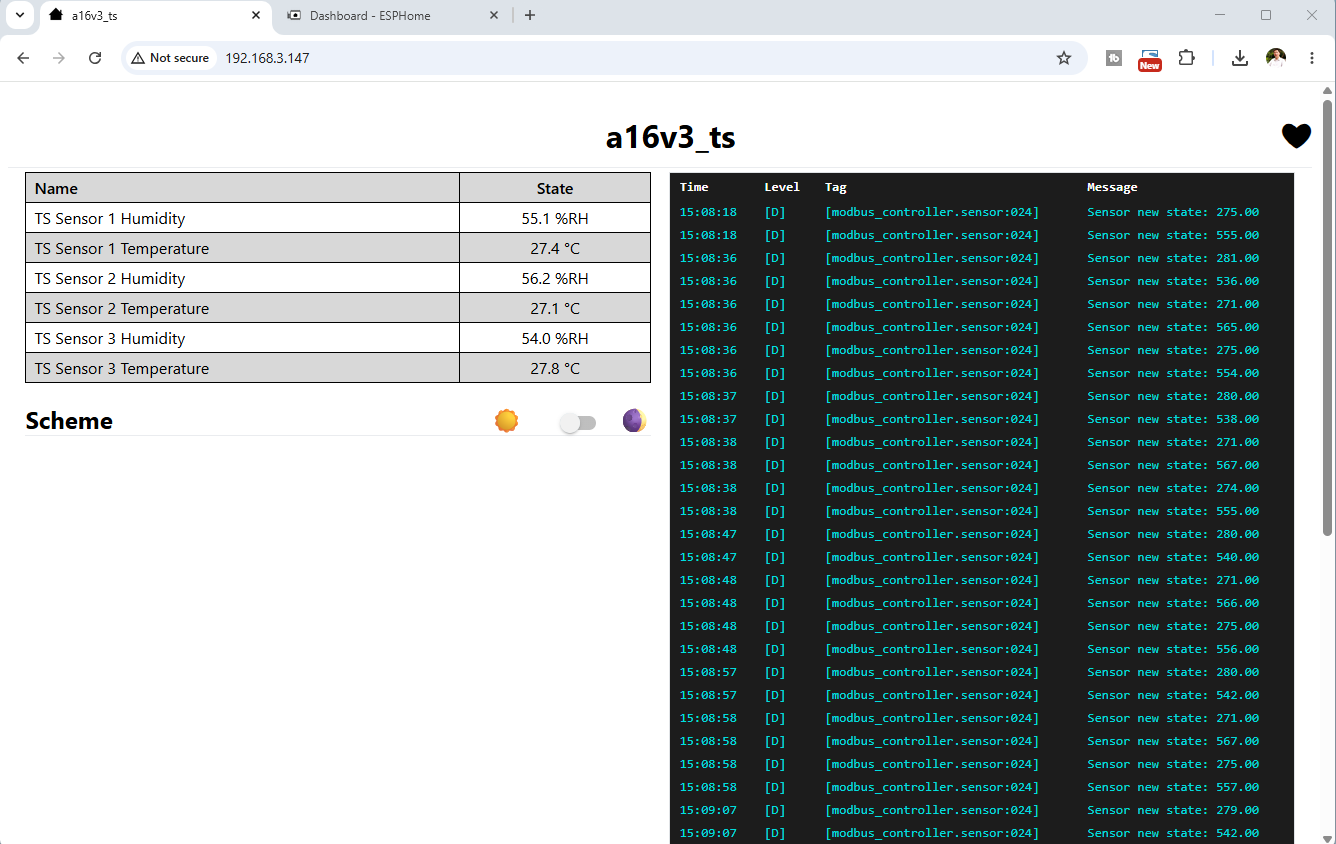

here is ESPHome yaml
  friendly_name: a16v3_ts
esp32:
  board: esp32-s3-devkitc-1
  framework:
    type: esp-idf
  hardware_uart: USB_SERIAL_JTAG
ethernet:
  type: W5500
  clk_pin: GPIO42
  mosi_pin: GPIO43
  miso_pin: GPIO44
  cs_pin: GPIO15
  interrupt_pin: GPIO2
  reset_pin: GPIO1
uart:
  - id: uart_RS485
    baud_rate: 9600
    tx_pin: 16
    rx_pin: 17
modbus:
  - id: modbus_ts
    uart_id: uart_RS485
    send_wait_time: 50ms
# Sensor 1 - Address 1
modbus_controller:
  - id: ts_sensor_1
    modbus_id: modbus_ts
    address: 0x01
    command_throttle: 200ms
    setup_priority: -10
    update_interval: 10s
  - id: ts_sensor_2
    address: 0x02
    setup_priority: -10
  - id: ts_sensor_3
    address: 0x03
    setup_priority: -10
sensor:
  # Sensor 1 Temperature (Address 1)
  - platform: modbus_controller
    modbus_controller_id: ts_sensor_1
    name: "TS Sensor 1 Temperature"
    register_type: holding
    address: 0x0000
    unit_of_measurement: "°C"
    accuracy_decimals: 1
    value_type: U_WORD
    filters:
      - lambda: |-
          if (x >= 10000) {
            return -1 * (x - 10000) * 0.1;
          } else {
            return x * 0.1;
  # Sensor 1 Humidity (Address 1)
    name: "TS Sensor 1 Humidity"
    address: 0x0001
    unit_of_measurement: "%RH"
    value_type: U_WORD
    filters:
      - lambda: return x * 0.1;
# Sensor 2 - Address 2
  # Sensor 2 Temperature (Address 2)
    modbus_controller_id: ts_sensor_2
    name: "TS Sensor 2 Temperature"
    address: 0x0000
    value_type: U_WORD
    filters:
      - lambda: |-
          if (x >= 10000) {
          } else {
            return x * 0.1;
  # Sensor 2 Humidity (Address 2)
    name: "TS Sensor 2 Humidity"
    address: 0x0001
    value_type: U_WORD
    filters:
# Sensor 3 - Address 3
  # Sensor 3 Temperature (Address 3)
    modbus_controller_id: ts_sensor_3
    name: "TS Sensor 3 Temperature"
    address: 0x0000
    value_type: U_WORD
    filters:
      - lambda: |-
          if (x >= 10000) {
          } else {
            return x * 0.1;
  # Sensor 3 Humidity (Address 3)
    name: "TS Sensor 3 Humidity"
    address: 0x0001
    value_type: U_WORD
    filters:
