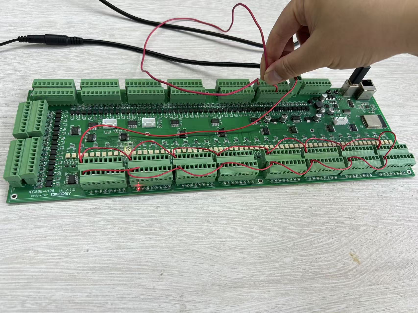

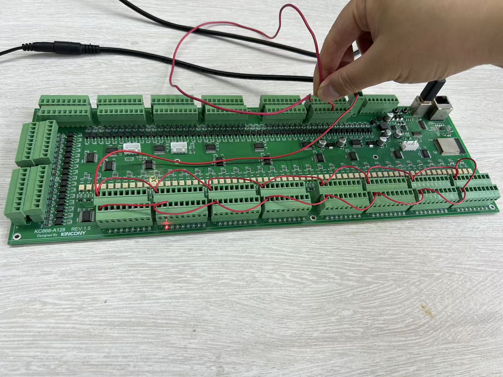

[Arduino IDE demo source code for KC868-A128]--#05--Digital input trigger output
  Made by KinCony IoT: https://www.kincony.com
  KC868-A128
  DI1 -> DO1
  DI2 -> DO2
  DI128 -> DO128
  IIC Bus-A for relay DO:
  SDA = GPIO5
  SCL = GPIO16
  IIC Bus-B for DI:
  SDA = GPIO15
  SCL = GPIO4
