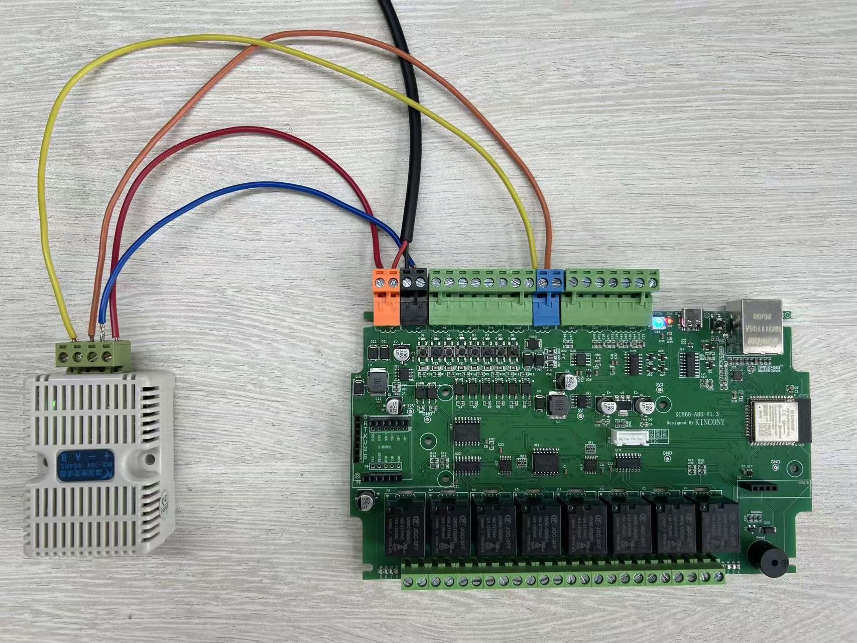

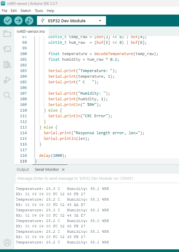

[Arduino IDE demo source code for KC868-A8S]--#18-Read Modbus sensor by RS485
KC868-A8S read KinCony TS modbus sensor by RS485.  USB print the temperature and humidity value.
  Made by KinCony IoT
  https://www.kincony.com

  if (len == 9) {
    Serial.print("RX: ");
    for (int i = 0; i < len; i++) {
      if (buf[i] < 0x10) Serial.print("0");
      Serial.print(buf[i], HEX);
      Serial.print(" ");
    Serial.println();
    uint16_t crc_recv = buf[7] | (buf[8] << 8);
    uint16_t crc_calc = modbusCRC(buf, 7);
    if (crc_recv == crc_calc) {
      uint16_t temp_raw = (buf[3] << 8) | buf[4];
      uint16_t hum_raw  = (buf[5] << 8) | buf[6];
      float temperature = decodeTemperature(temp_raw);
      float humidity = hum_raw * 0.1;
      Serial.print("Temperature: ");
      Serial.print(temperature, 1);
      Serial.print(" C   ");
      Serial.print("Humidity: ");
      Serial.print(humidity, 1);
      Serial.println(" %RH");
    } else {
      Serial.println("CRC Error");
  } else {
    Serial.print("Response length error, len=");
    Serial.println(len);
  delay(1000);
