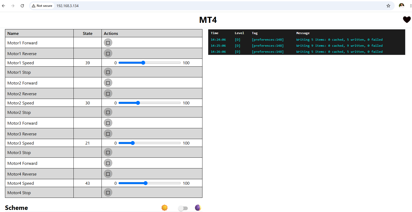

MT4 ESPHome yaml for home assistant without tuya
  friendly_name: MT4
esp32:
  board: esp32-s3-devkitc-1
  framework:
    type: esp-idf
ethernet:
  type: W5500
  clk_pin: GPIO42
  mosi_pin: GPIO43
  miso_pin: GPIO44
  cs_pin: GPIO41
  interrupt_pin: GPIO2
  reset_pin: GPIO1
web_server:

button:
  - platform: template
    on_press:
      - globals.set:
          value: '1'
      - script.execute: motor1_forward

number:
    min_value: 0
    max_value: 100
    step: 1
    optimistic: true
    restore_value: true
    initial_value: 50
    set_action:
      - globals.set:
          value: !lambda "return x / 100.0;"
      - if:
          condition:
            lambda: "return id(motor1_direction) == 1;"
          then:
      - if:
          condition:
            lambda: "return id(motor1_direction) == -1;"
          then:
            - script.execute: motor1_reverse

yaml file download:
.txt   HA_4_motor.txt (Size: 9 KB / Downloads: 126)
